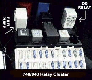

You're in luck paisano! Beginning with the 7 series, Volvo centralized most all of the relays. They are behind the fuse tray which is, itself, behind the ashtray. Kind of difficult to see in their but this is the arrangement...
I wouldn't go ***** nilly disecting the o.d. button unless it's a hobby or something. Those auto shifter ***** sometimes don't go back together as simply as they disassemble. I'd try to test the wiring first. Honestly, the o.d. relay failing is your best bet. That's the most obvious place where it could happen; you have power to energize the circuit and a circuit that normally controls the electricity.

The relay may be OK. I have a similar problem with my 94 940. The overdrive relay is fairly large and heavy and I find that it has worn a bit loose in the connector, sometimes making contact, other times not. Before replaceing it, try wiggling this relay and push it down to see if this helps out.
