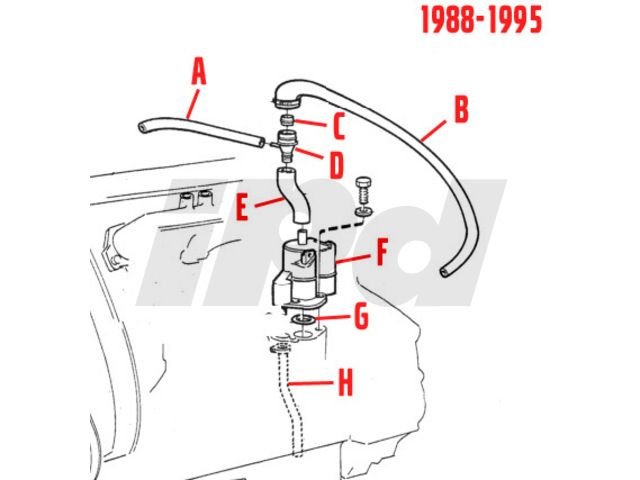

About once every 30K miles or so, remove the flametrap that's in the tube fitting on the top of the box, and swish it in a tin of solvent, put it back unless the wholes are completely clogged, then replace it (its cheap!)... about once every 200K miles, remove the oil separator box and swish a little solvent in it amnd inspect it, replace only if its cracked or broken, as the replacement plastics probably aren't as good as the original.. Brake Kleen is way too strong for the plastic, I'd at most use throttle body cleaner, or something like that, or just mineral spirits.
the flame trap itself is this little disk "C", the oil separator is 'F'
