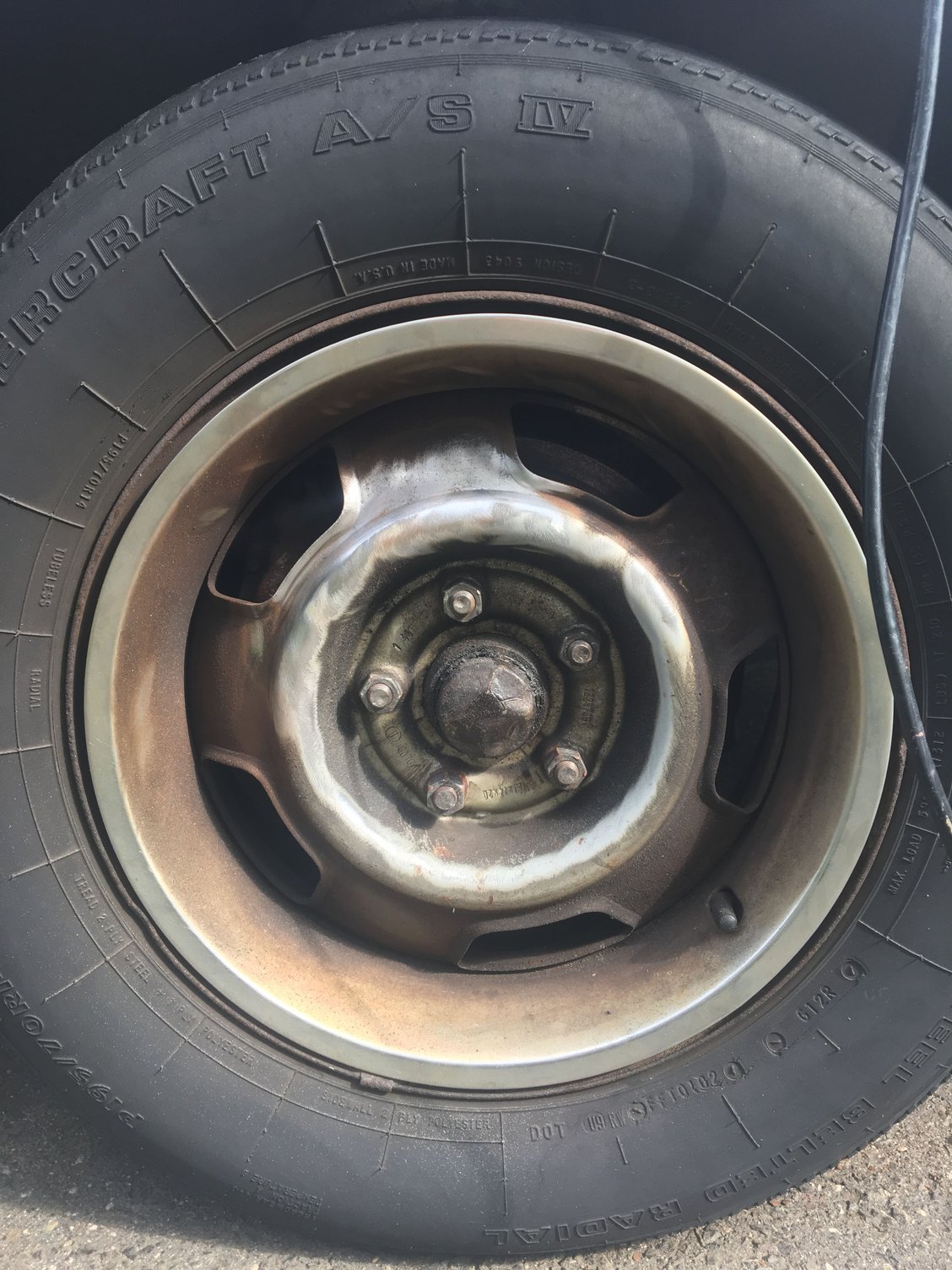

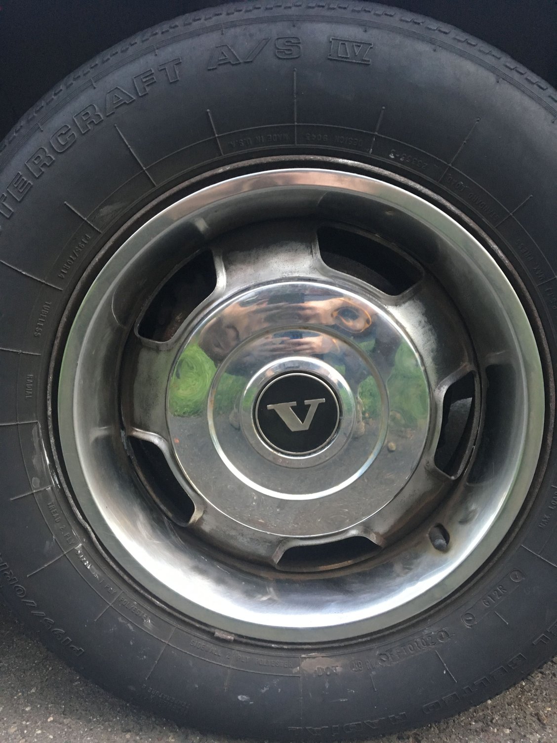

I put some pictures of the Wagon just incase anyone interested.
