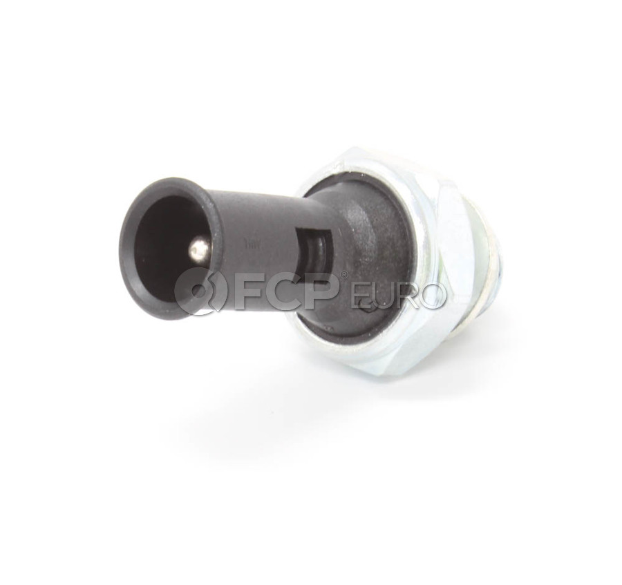

OBD does not care about oil pressure, you will not find any info with your OBD port related to oil pressure. The check engine light will not come on if there is no oil pressure -
The sending unit simply grounds the attached wire when oil pressure is below ~7 psi.
Pull the wire off the sending unit, use a jumper wire and ground it to the alternator. The warning light should be illuminated on the dash with the key on. If not - that wire goes directly to the instrument cluster to one side of the warning light bulb. A common failure point is the multi-connector in the center in the firewall where the engine wire harness connects.
You can also test the sending unit with an ohmmeter. should be 0 ohms or open circuit on the sending unit to ground with the engine off, and if oil pressure is more than 7 psi that same test will be a closed circuit with the engine running.

Tried jumping it this morning but saw nothing on the dash while the key was on or while the engine running. I jumped it to three different nodes on the alternator cause I am not sure which one is the ground. I will pull off the dash cluster and see if I can find anything wrong there, maybe a bad bulb? I'm also wondering if the sending unit is bad...

Finally got some time to attempt your suggestions. I tried jumping the sending unit to the alternator ground but no light came on while the key was in position 2. Picture below of the ground I attached to. I checked the bulb of the oil light and all the connections to the instrument cluster and all looked good. I ordered a oil pressure tester from Autozone to rent so I will try that out when it comes in. Also not sure if my jumper is good.
