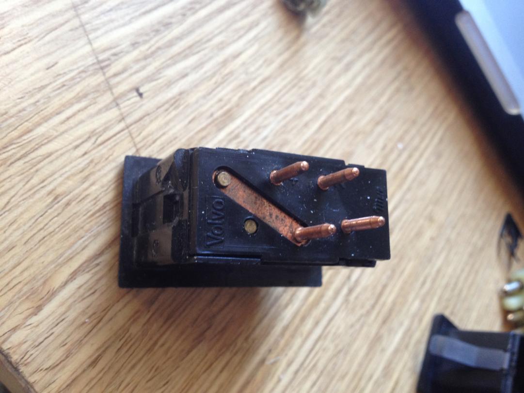

Im hoping the right person reads this, I'm looking for these window switches, Working or Not. i have a few spare parts here....
They have Volvo stamped in the back and Mera in cursive on top they say 13, 89
they are not the generic factory installed window switches, i believe they are dealer installed option. There are 2 in the center dash, and two were in a special Volvo switch box that was mounted to the center console for the rear.

They are factory Volvo, first generation 240. Try places that specialize in vintage Volvo parts.
Old Sep 4, 2014 | 02:26 AM
oh I thought I'd looked before at the early prints. the 75-76 greenbook shows no power windows, but I see them there on a 77-78 wiring diagram. the 4-door had the rear windows on the top of the center console behind the parking brake. also 1979.
in 1980 they moved to the doors.
looks to be volvo PN 1215138 for those switches.

Is the old switch broken? It can be taken apart and the contacts cleaned. I have done this before, but not with your switch.
Usually need to lift the housing over some barbs. It may be worth a try. Then clean the contacts with 400 sandpaper.
Old Sep 6, 2014 | 10:02 AM
eeeek, don't use 400 grit on plated switch contacts, you'll remove any residual plating. it will work for a little while then corrode up even faster than before.
I've successfully cleaned switch and other electrical contacts with a clean soft pink pencil eraser and a bit of deoxit d100 (which is an electrical contact lubricant).

I wish it was only bad contacts, It arrived this way to me from the P/O, the switch was already broken, i have a few extra internal parts for it though, so that why i was looking for switches working, or not...
I took the others apart and cleaned them with just a rag, seemed to me most of the junk in there was dust and dirt held up by 30 year old electrical grease. wiped em down with a rag, blew them out with a little air, greased em up, and the ones that have all the internal parts are working great!
