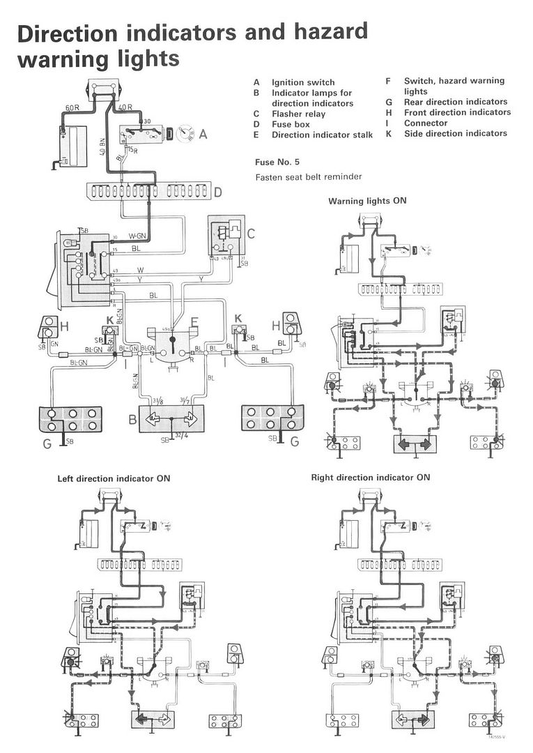

$140??? I saw a set of side marker lamps on ebay for $30 dollars same style. If not pre-wired, then ill make a harness myself. Also, from the alldata I looked at the wiring diagram for the signal. It seems there is wiring for the side marker.
Take a look, or maybe the diagram is for europe spec?

That looks like it is a european wiring diagram. I doubt your car is prewired.

Thanks! I guess I'll make a harness. Yeah IPD sells it way too much, thats why i rather get the one on ebay.
Redbrick, it is just two wires (blk,red), splice connector, and to the lamp what size is the connector to it?

See the sketches for setting them up. Very easy to do.
