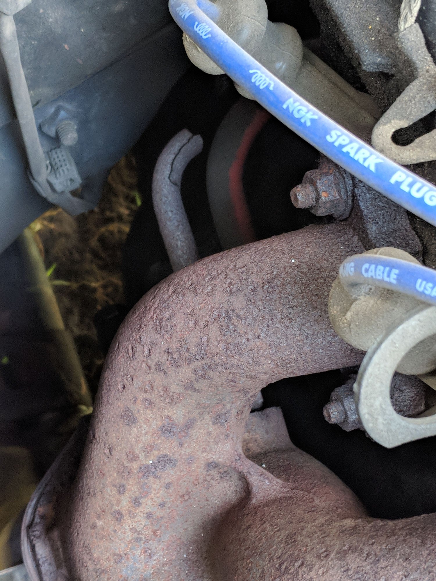

I have searched and looked in my Chiltons, and I just cant figure it out, on my drive home i hear something hit the underside of my car and suddenly a lawnmower noise, tracked the noise to this broke pipe lookong thing, seriously at a loss. I didnt have any power loss, the car idles fine, everything is running great, save for this ridiculous noise tons

That's an old EGR tube that has rotted apart and fallen off. It is also a safety issue since you are leaking exhaust fumes under the hood and those can kill you slowly.
My suggestion is to remove the exhaust manifold and ask a local machine shop to remove the tube from the manifold. They will probably have to heat it cherry red to get it out. As you are waiting for that to come back from the machine shop, you can shop for the new part, most likely available from the dealer. the other end of the EGR pipe will usually come off with a little effort.
Replace it now!

Thank you! I looked on IPD at identifying EGR in the 92 240 but literally none of the diagrams looked like this one. I'll be taking the exhaust off today and take care of it at my brother in law's shop (he's a machinist)

This was the other end of the EGR... I think the previous owner already did an EGR delete because this was just sitting behind the motor with this end just hanging out under the intake manifold... This car has already had plenty of surprises in it, like hidden behind the black squares on the dash are a coolant temp gauge and an oil pressure gauge, any idea why someone would do it like this?

Well, another part from the dealer I guess. This was a buggered up job and whoever did this needs to understand that such "repairs" are unsafe.

I see from the emissions plate that's a California car... all California cars have EGR starting around model year 1990. maybe a couple years earlier... I know our 1987 240 did NOT have EGR but my 1992 740 did as did my son's 1991 940.
I also don't see the EGR control valve in that last pic, it should be forward of the driver side strut tower. several vacuum nipples on your throttle appear to be capped off, too.
