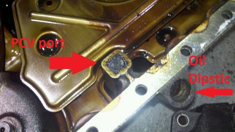

Did you try to blow through the ports in the engine to see if they were open ?? It's the passage in the pan that can be a nightmare. The port numbered "1" is the one that mates up with the cast passage in the second picture that leads to the bottom of the oil pan. That is the one that can give you the most trouble.
Did you double check all the hoses to make sure you didn't have one pull off during reassembly ??
If nothing on those two, you might want to do a compression test and see where you're at. There is a chance it's that worn and you just have too much blow-by from the rings for the system to handle . . . pretty unlikely but possible.

From your pictures it looks like the only way to access the passage in the pan is to drop the pan, is that correct? I'll go through and try double checking everything I can.

From what I've read the only way to open that up is by pulling the pan. If anyone knows another way please jump in !!!!
The worst part is it doesn't only go down below the level of the oil but it's actually a "J" as it goes to the bottom and them hooks up.
Picture with the oil pan baffle removed.
