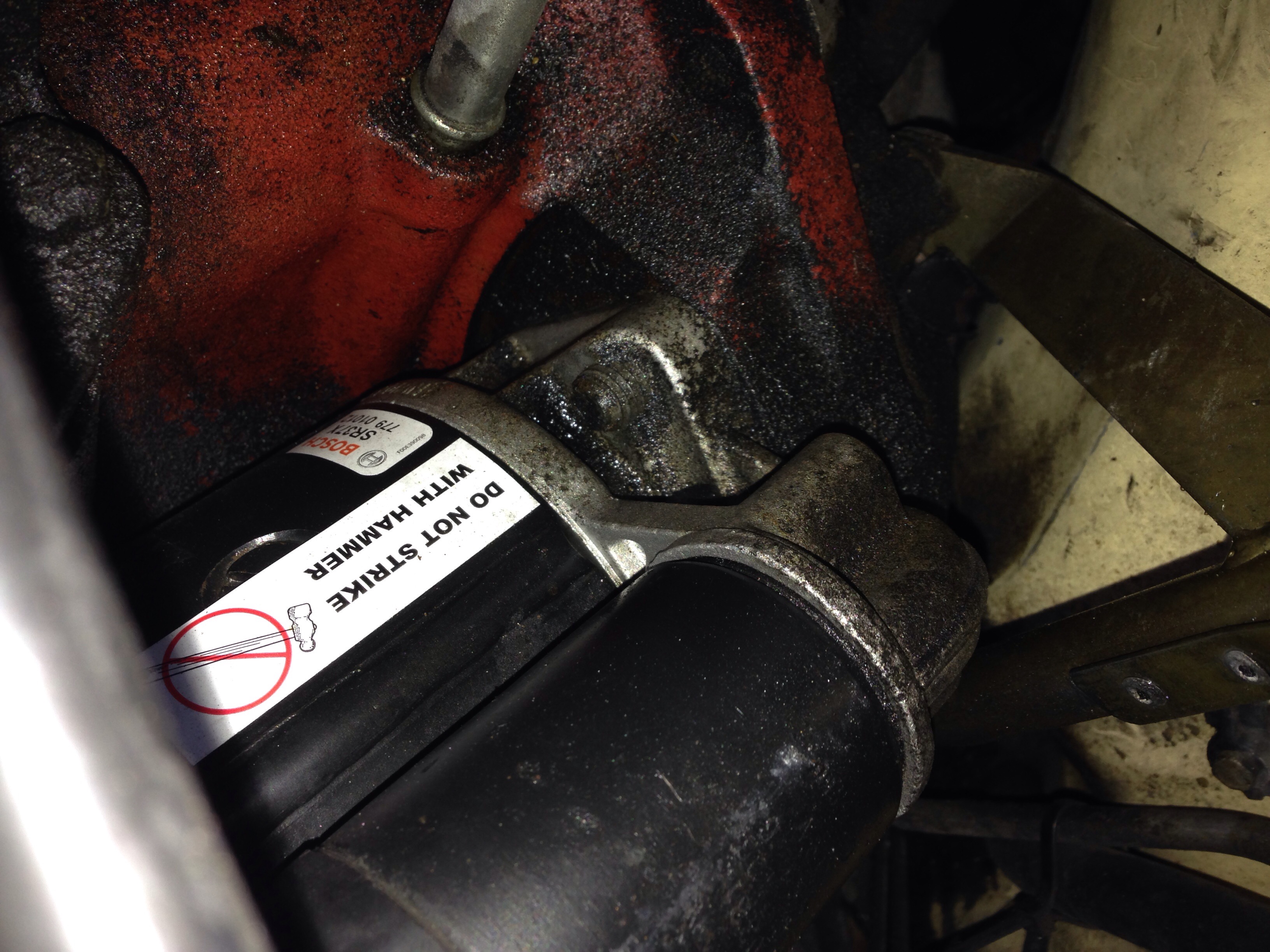

Looks like there is supposed to be a nut on the top side of the starter...? Mine is MIA, probably not helping.
I tried to post a pic but I wasn't able to from my iPhone.

See if this pic works, the main nut for the actual starter. looks like there should be one anyway.

pretty sure thats the pointy end of a bolt thats put in from the other side, and threads into the starter flange.

That's the back end of the top bolt that attaches the starter, the one that's a pain in the *** to get out... It's fine!

Well I feel stupid now... Thanks guys!
