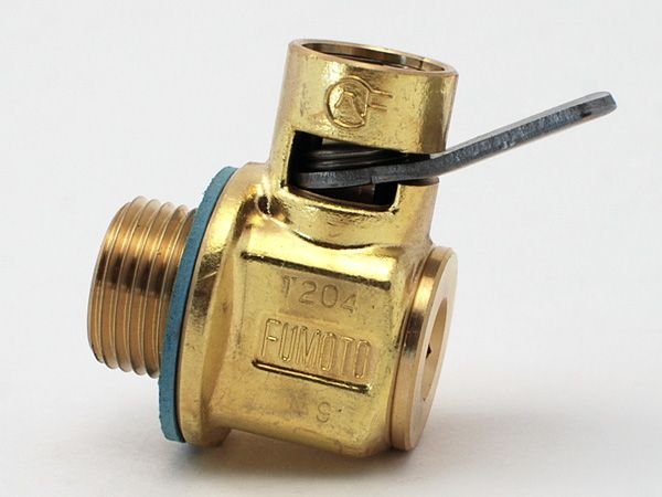

this fumoto does fit all the B230's...
T-204 | Fumoto® Engine Oil Drain Valves
picture shows it in the open position, that lever would be horizontal and pointing 'towards' the camera when closed.
