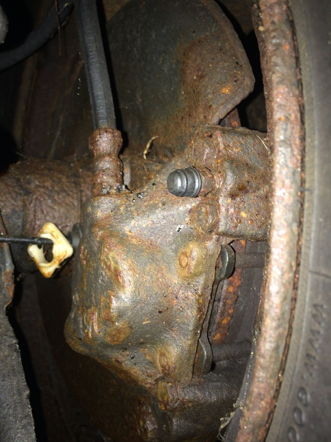

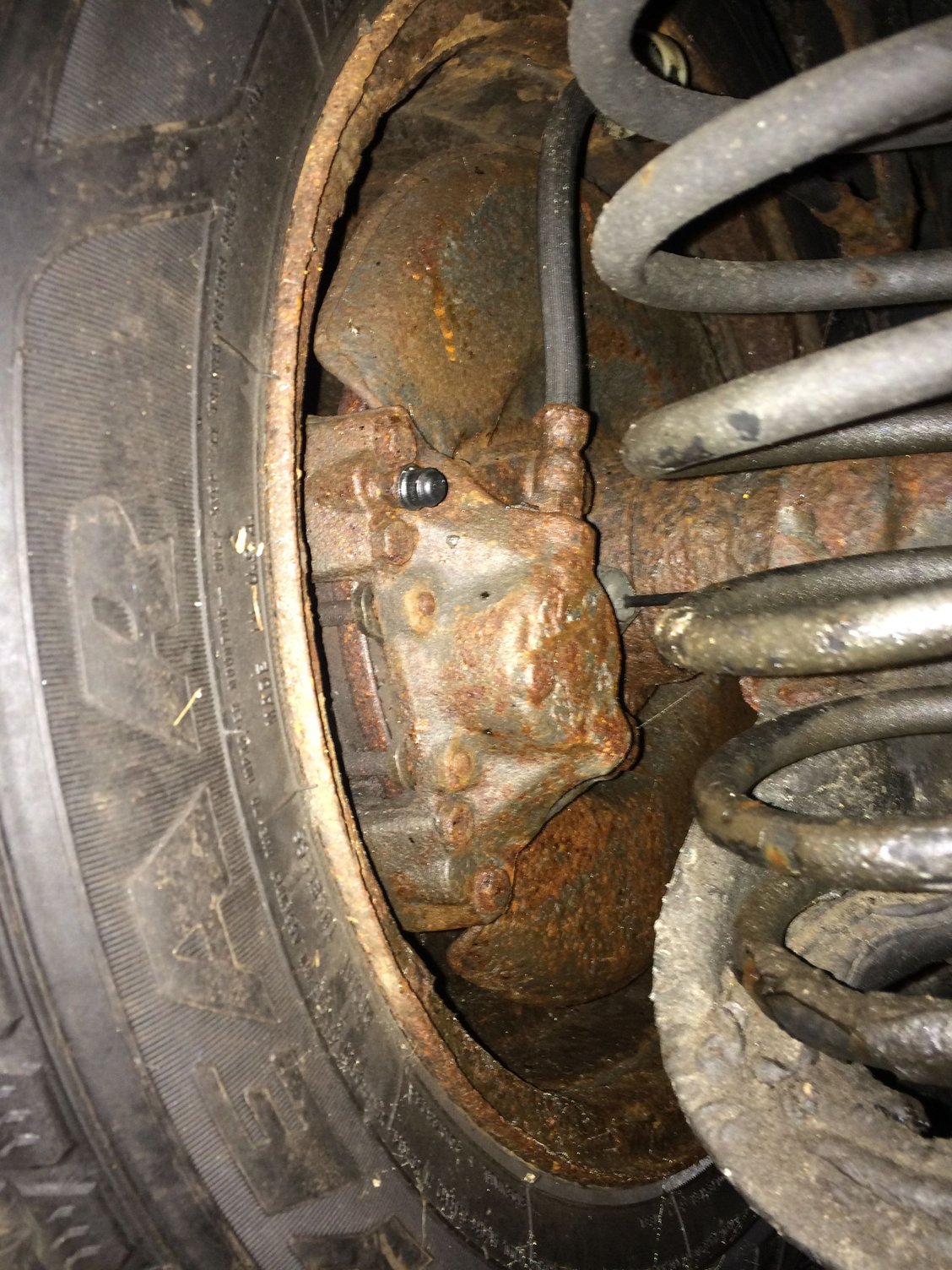

My rust-terror having now been aggravated I’m going to bomb you with pics of the rear stuff in case I should just declare victory and depart the field here...

um, a brake job normally only replaces the pads and the rotors. its not so much the calibers that scare me on your car as the REST of the steering/suspension bits, the control arms and so forth.

The rear pads look good, may be you can leave those alone. The pins look frozen solid anyway, and the front is what's important so keep soaking the front, hopefully you'll be able to break them loose without stripping them.

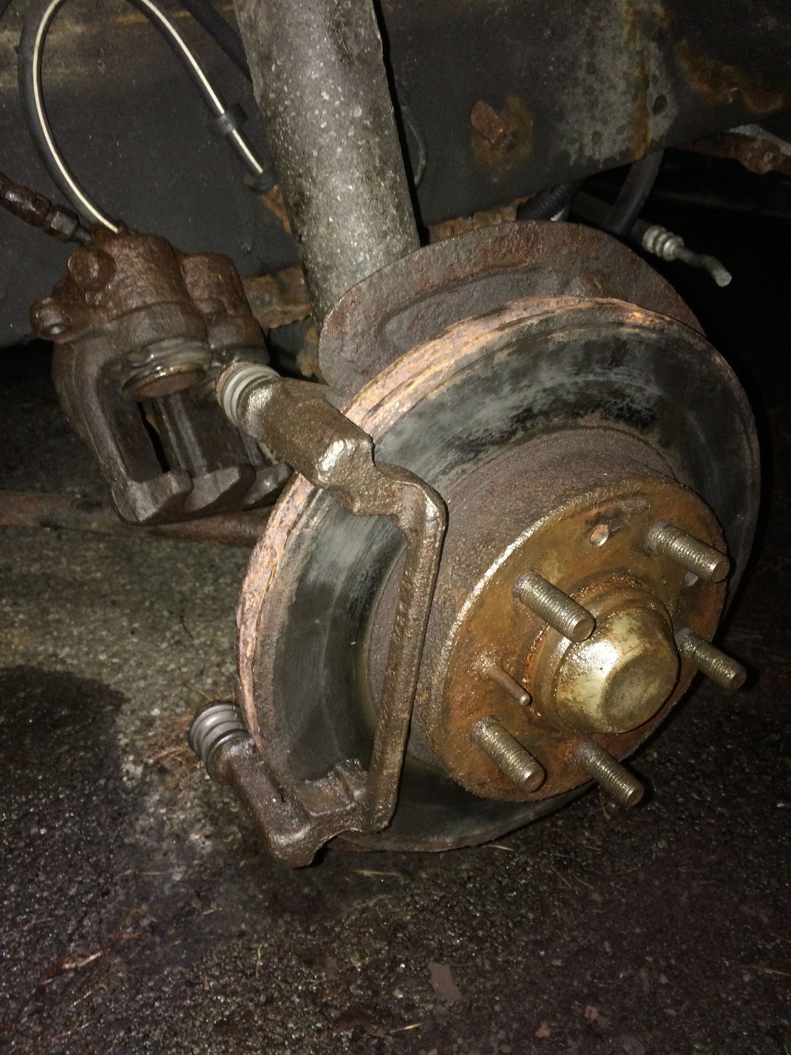

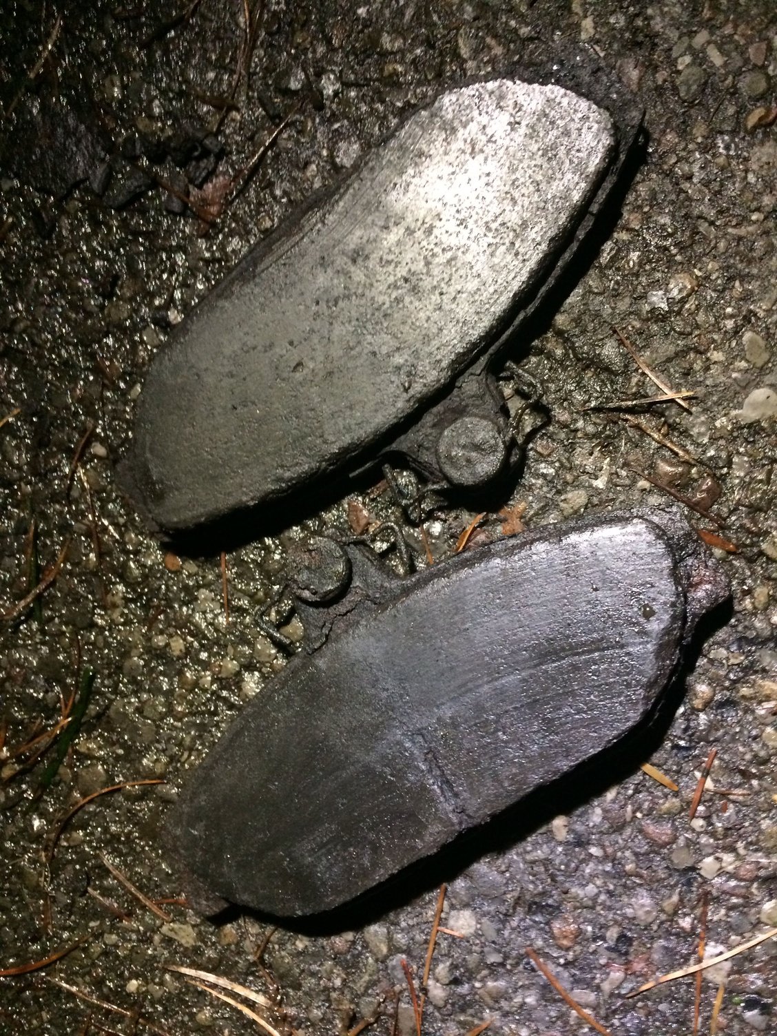

So.... can you tell from the pics (right front brake pictured) what pads (and rotors) I need? Can't see a manufacturer name on the calipers. (Plus you made it sound like it's not that straightforward finding the right brake parts for these cars from the catalogs...?)

First, congrats on being able to take off these pads, the rust had me scared!
Those pads are bad, they have been there a long time, change them. As far as what kind of pad you need, go to the IPD web site and look at the different pictures of the available pads, you'll get the idea, compare them to what you have. The rotors don't look scarred but I can't tell if they are out of round. Just do the pads.
Old Dec 2, 2020 | 12:27 AM
  #153

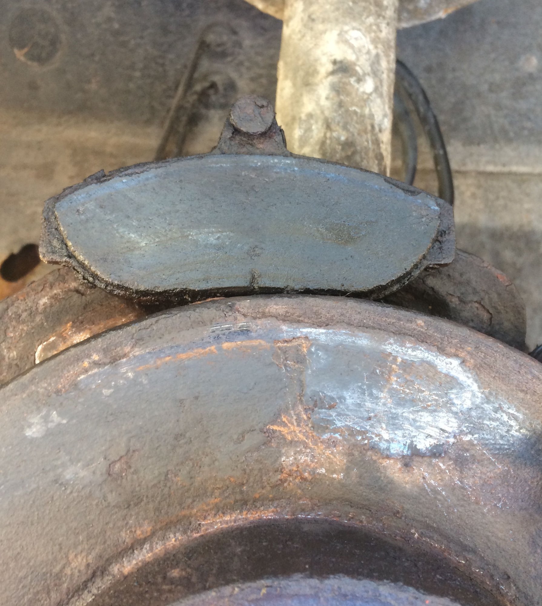

the rotor shown looks deeply worn over about 2/3rds of its surface. they definitely should be measured with a brake caliber, and replaced if any part of them is below the minimum thickness spec.
absolutely for sure, you should do a brake fluid change and flush. I assume this car has ABS, that means you need a pump to flush it, the old pumping the brake pedals method is inadequate.

The snow that fell today will melt tomorrow if the forecast is right; planning on sending better pics of rotors tomorrow, for what that's worth. Thinking now I just have to get the car to the point where I can actually brake to a stop so I can drive it to someone else to do all the other stuff. (Ordering the pads from IPD was in fact pretty straightforward; the style of the pads I'm replacing is fairly distinctive.)

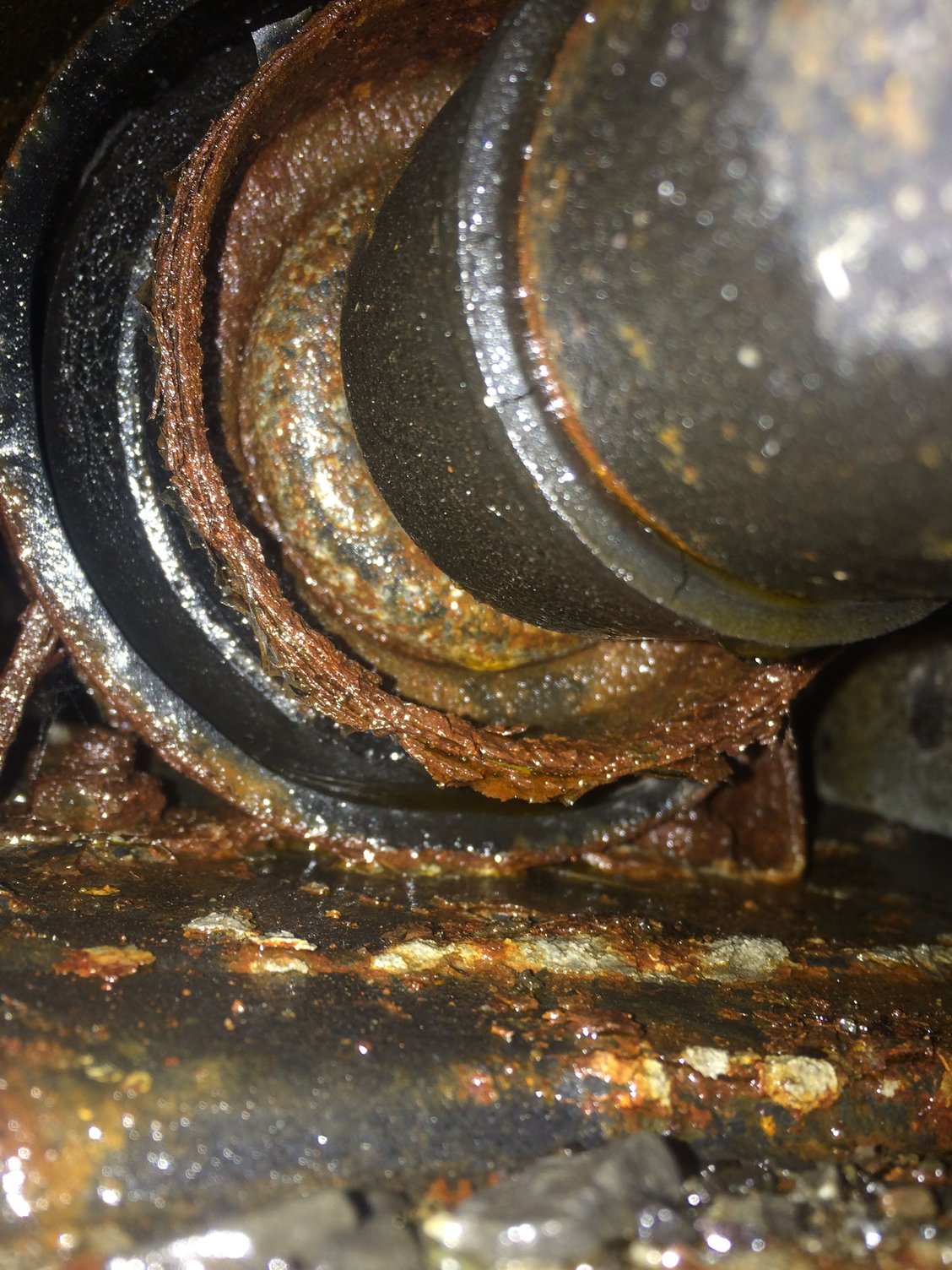

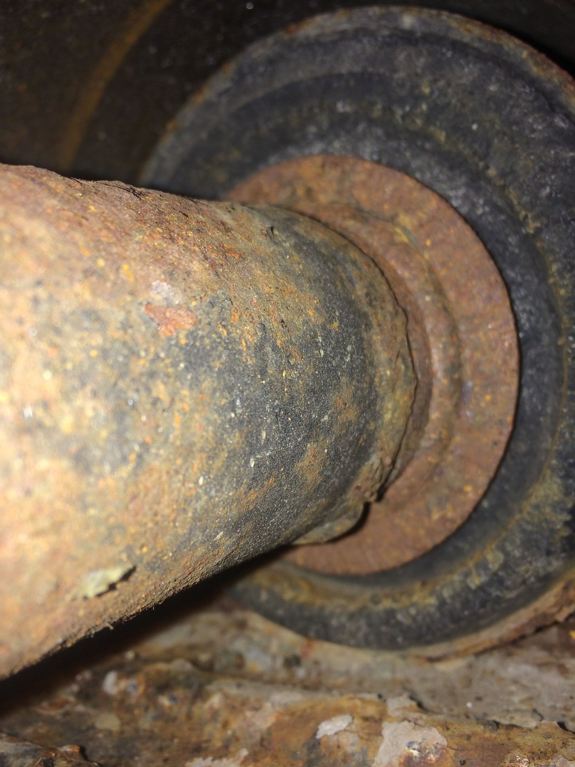

most likely, thats the drive shaft center bearing. its just forward of the middle U-joint in the driveshaft there's a rather large ball bearing, surrounded by a rubber carrier/bushings, in a metal bracket.
this is one on a driveshaft thats out of the car.
oh, BIG NOTE! if you take the driveshaft apart, and have to separate the front and rear shafts, MARK THEM at the splines so you reassemble it aligned EXACTLY the same way. this is VERY important, as the driveshaft was balanced as a whole assembly. if you assemble it misaligned, you'll have significant and nasty vibrations at speed.
Old Dec 2, 2020 | 05:22 PM
  #156
so the center bearing is 3, the rubber cups and seats are 4-5-6, the bearing carrier is 2. the rubber bits should be replaced with the bearing, the carrier bracket is fine unless its physically damaged.
the top row shows the front shaft 13 for an automatic (the one just below it with the flexdisk 17 is for a manual stick shift), then the center bearing stack is slid on the back end of that front shaft, the back half of the front shaft 14 has the spline I talk about above that has to be indexed correctly, then the middle (8) and rear (10) U joint are on the rear shaft 15.

For the time being you can squirt some lubricant on the driveshaft bearing, U joints, etc, to quiet it and verify that that is the problem--I think it is since bad transmissions rarely if ever make the noise you described.
I wouldn't worry too much about the rotor thickness, and you can change the brake fluid just fine without flushing it with a special machine, etc. Running to a shop for every little thing is not the answer, the idea is to DIY and improvise. Looks like you won't need a transmission... Once this car is running and used many of these kinks will disappear, hopefully the rust we don't see won't be a problem.

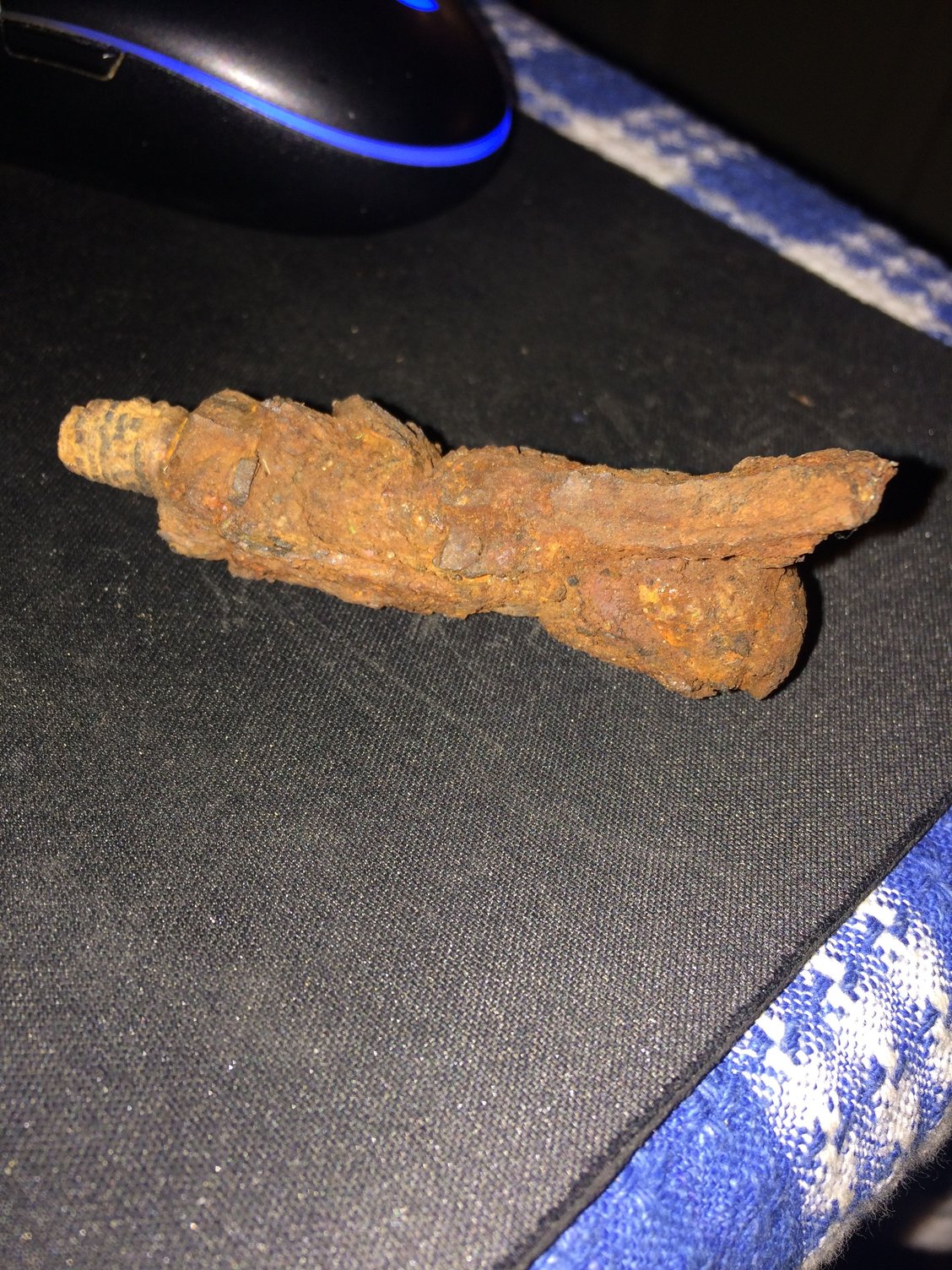

BTW, the rusty piece that fell off might be part of the parking brake assembly...
What is the cut hose on the photo of the rotor, right upper corner, an A/C line?

And yeah, parking brake sounds right... I think I recall hearing a k-THUNGggg when I first freed the car from its frozen/immobile state by putting it in "D" and rolling forward... I thought it was just the brakes breaking their rusty bonds but maybe what really broke was the parking brake (though pretty sure parking brake was not on at the time?). I'll have to look (where exactly?)... and test it after I have new pads in...

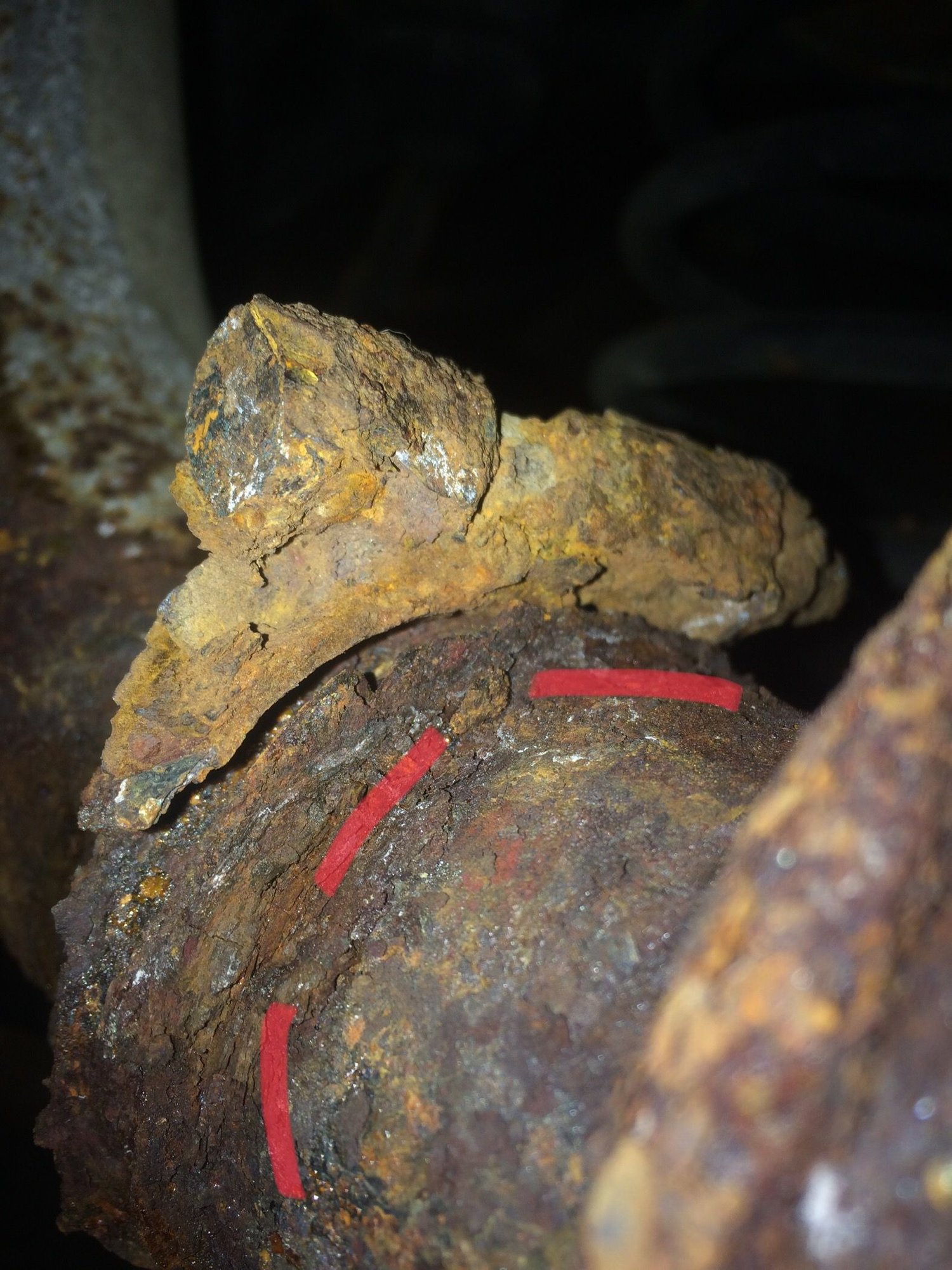

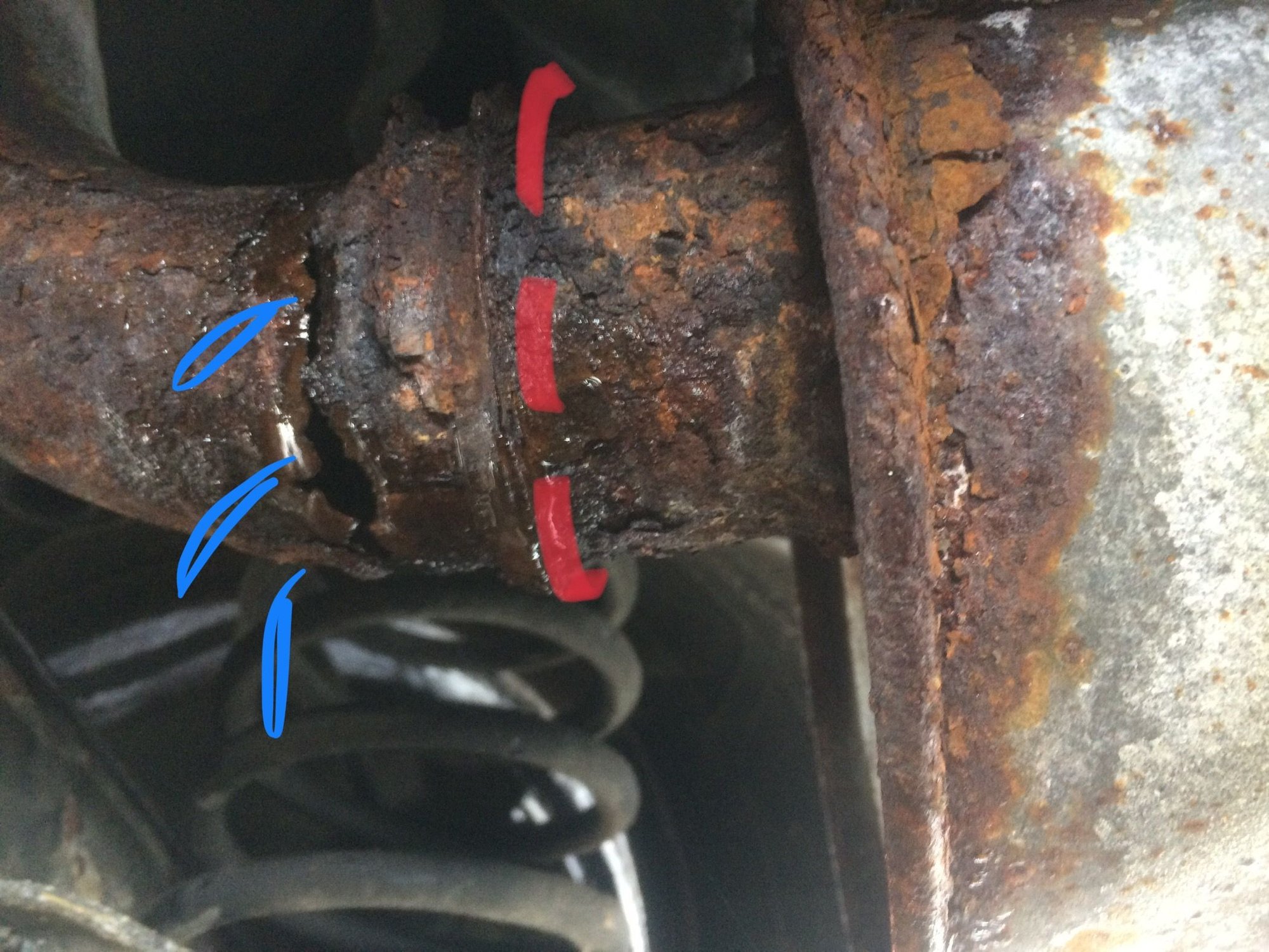

Hey (sorry in advance for bombing you with more gigantic pics than usual):
I think I'm in it for the rotors. See the lead pic which shows what seems to be brake-pad-shaped scarring on the left front rotor... almost like that's where the brake-pad was formerly fused to the rotor. Guess that the brakes "breaking free" was my kTHUNGgggg after all. (Parking brake appears, including from under the car, to be functioning normally.) Looks like I have to get that caliper mount off to get the rotor off... what kind/size of tool is needed to take off the bolts circled in blue? (Also, is it a problem that the receptacles circled in red are, on the right hand brake, spinning freely, whereas the left-hand receptacles seem fixed/fused in place? The screws that came from the receptacles on the right-hand side, which screws of course hold the calipers in the mount, are lying on the cloth to the right of the screws that came from the left-hand side.) Also are these rotors OK or do you recommend going genuine Volvo (for twice the price, sigh)? The pads I ordered are Bosch also.

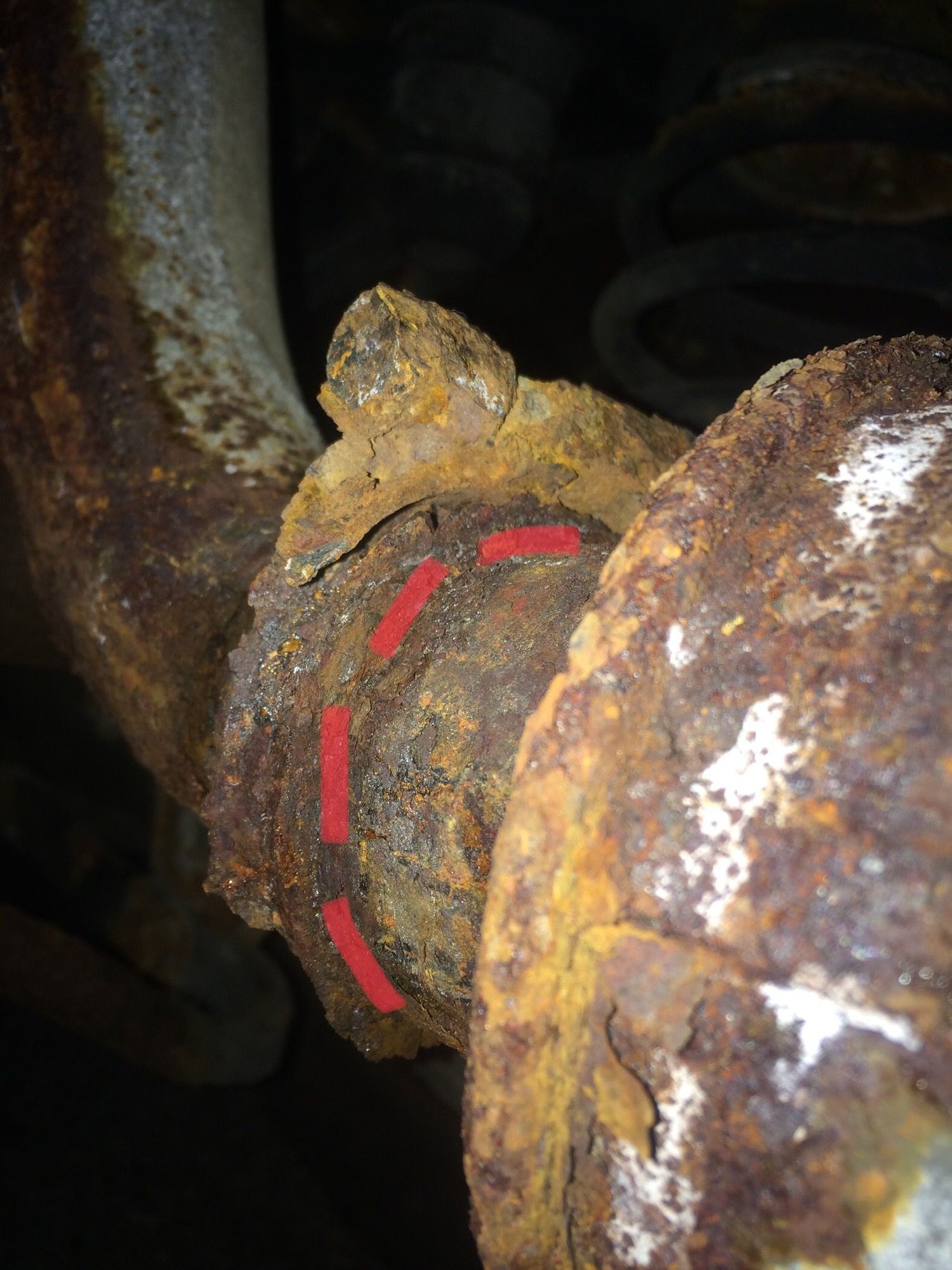

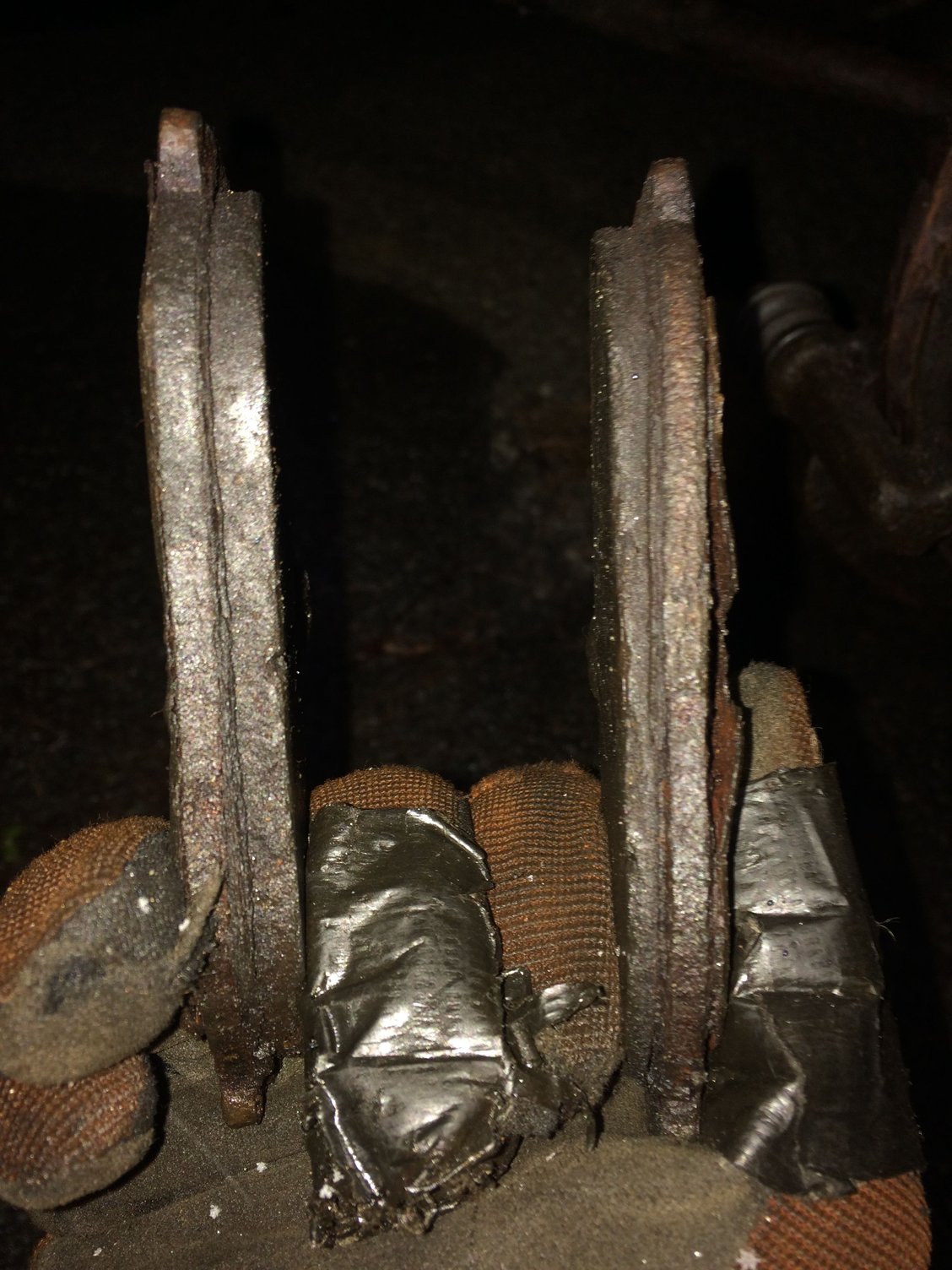

Pictured also is the center/carrier support bearing/housing (pictured looking toward rear of car and then looking toward front). I probably wasn't supposed to spray B'Laster on all that but jfc you can't blame me for freaking out a little here, can you? (I can almost hear pierce thinking, upon seeing this mess, "wtf are you even doing here bro"...)
On another note, do you think maybe that hunk of metal that looks like it was salvaged from the Titanic was part of a clamp holding the muffler to the (yes, leaking) exhaust pipe? It seems to fit in that groove I've drawn the red dotted line next to in these pics...
