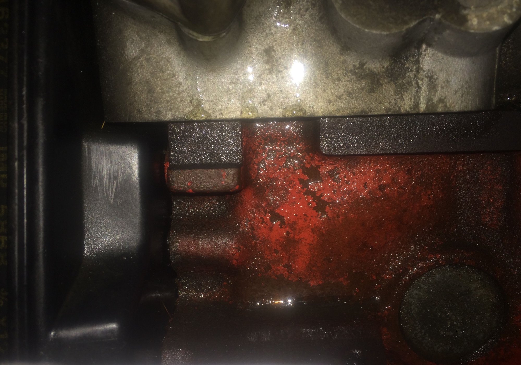

Unfortunately I am afraid that I may have put a little too much elbow grease into scouring the surface on the engine block where upper rad house couples with block and now it seems I can't get a good seal there? Is there a gasket that could remedy this?

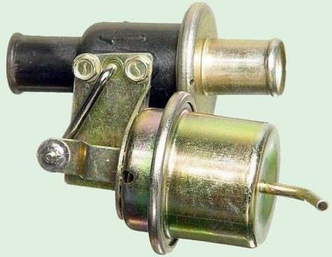

look at the heater valve, you can see it has a sort of vacuum bellow cylinder on the side, there's a pushrod coming out of this, thats connected to the lever that works the actual ball valve thats inline with heater water fittings.... when you move that lever from cold to hot, that lever should move from its cold/off position, maybe 60 degrees to the full hot/on position.
here's the original style heater valve....

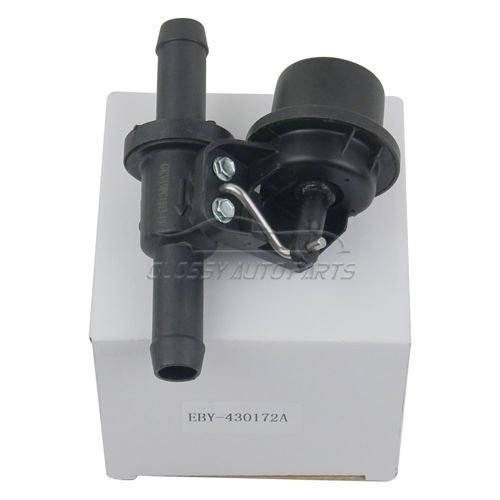

and this is the current Volvo OE replacement part (note more plastic, less stuff to rust)
and I previously linked a much cheaper perfectly functional 'generic' heater valve that works just fine, but has no visible external lever.

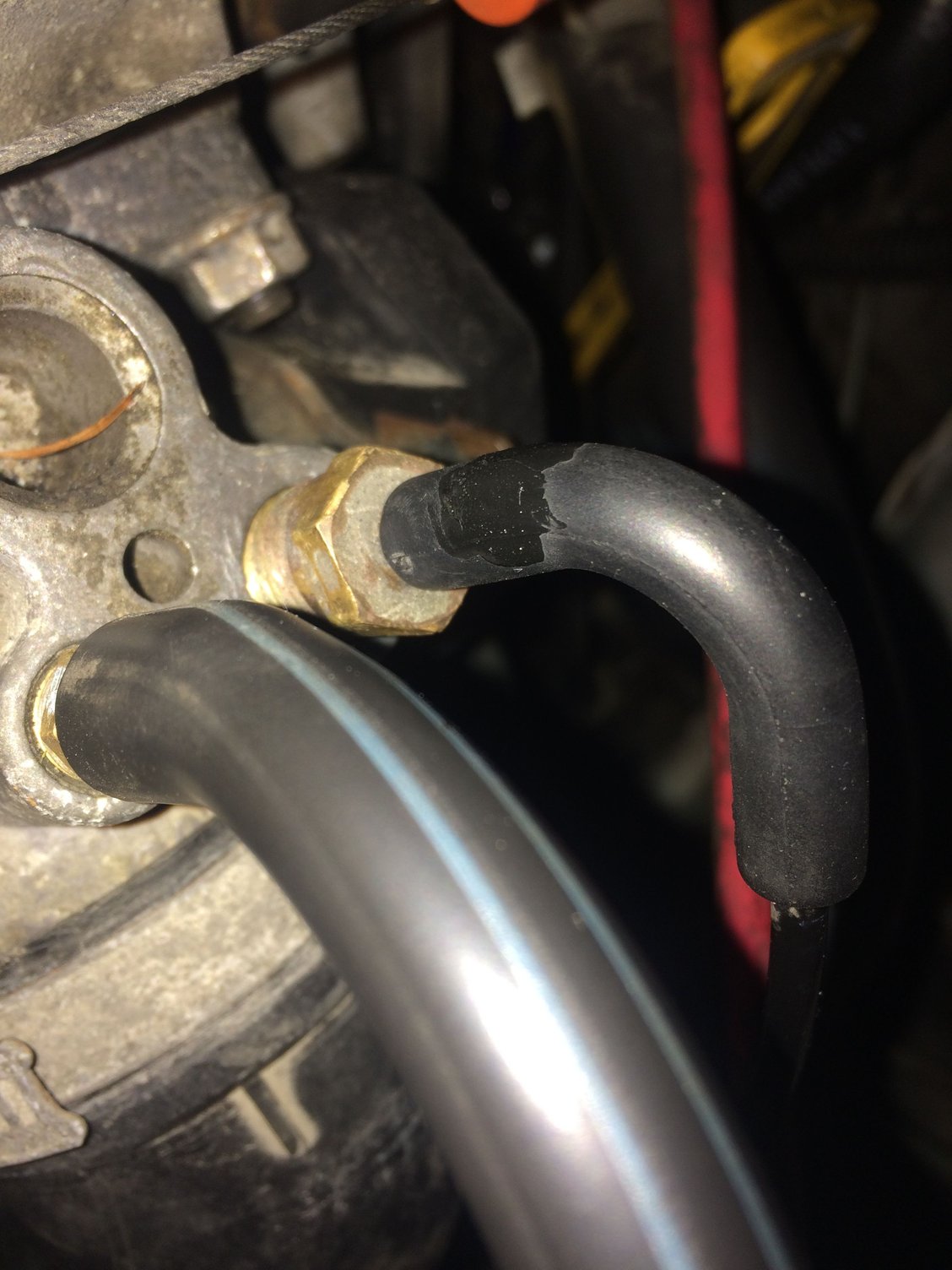

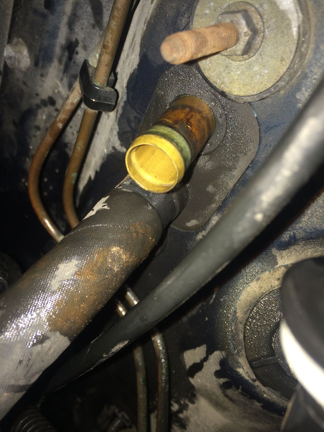

Disconnected battery and spread a glop of Gorilla Super Glue XL on the suspected vacuum leak before going to work this morning. Came back tonight, started up, drove around my driveway loop, and not only could not get the code to reappear but my idle never got stuck at 1500 rpm in park or in neutral or coming down from rev. So that felt good.
Treated IN hose with WD-40 last night (i.e., shoved wand between hose and firewall and sprayed, a lot). Tonight the hose was quite easily coaxed off. OUT hose felt very much like it needed same treatment so that’s cooking now.

i can't tell, did you remove the clamp on that 2nd heater hose? I would plan on replacing those hoses, and any others you can, also using new clamps. its probably worth it to get the crimping tool for the correct crimped clamps and not using generic screw clamps, they often get under or over tightened, either is bad.

..."correct crimped clamps"? No, Volvo never used the crimped type on the Red Blocks, those came much later. The crimpers are just cheaper to make and one time use, that's why they are used now, they are by no means better!
I wouldn't replace the hoses unless they need to be replaced, unless you want to throw $ away... OEM parts are much better quality and much more expensive, if you can even get them today.
