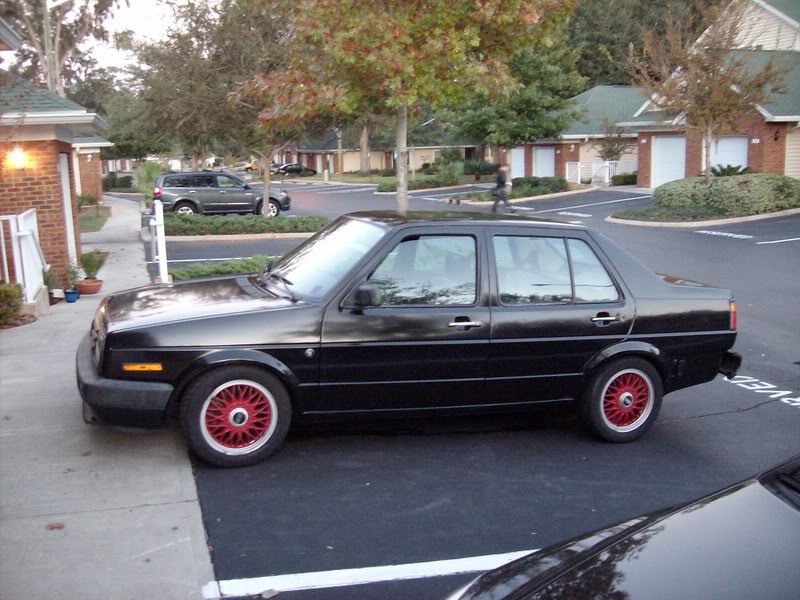

I wish I had a picture of my turbo K-Jet for you but I don't think I do. But also, since I am an Old VW guy and have been down this road many a times in the past. Let me insert some past cars here.
