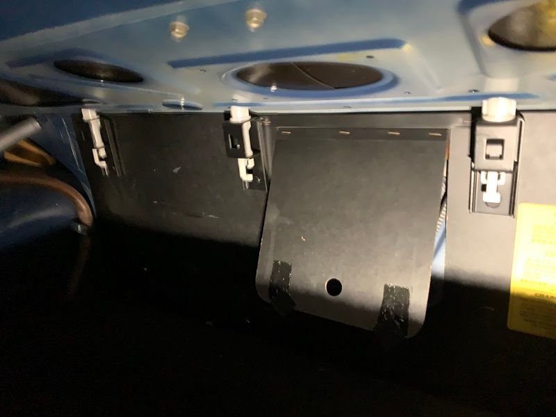

Hi, where did you get the new rear parcel shelf plastic vent pieces? also do you need to remove the rear seat in order to get the rear head rests off? I have the same color Volvo 240 as you. Mine is 1992. Any info helps, thanks.

The headrest come off without removing the back seat. There are 4 "tabs" in the trunk, 2 for each headrest. You have to pull out on the bottom of the 2 tabs while simultaneously pushing up on the headrest "pins". It is easiest with 2 people, one to release the 2 tabs and another to be inside the car pulling up on the headrest, but it can be done alone as I did.
Hope this helps.
Hope this helps.
This helps! Thank you. I am new to the Volvo forum!! Happy to be here.
