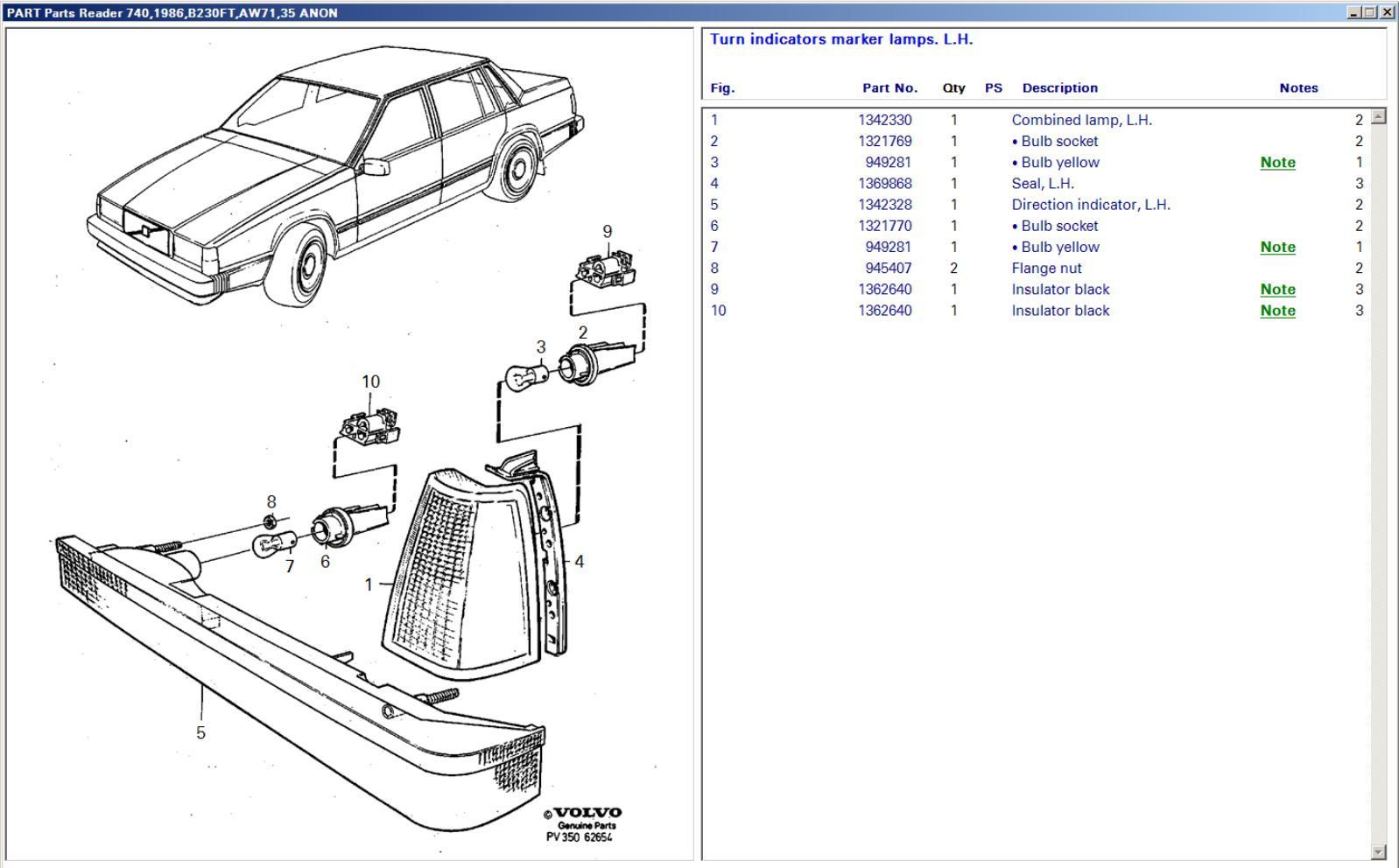

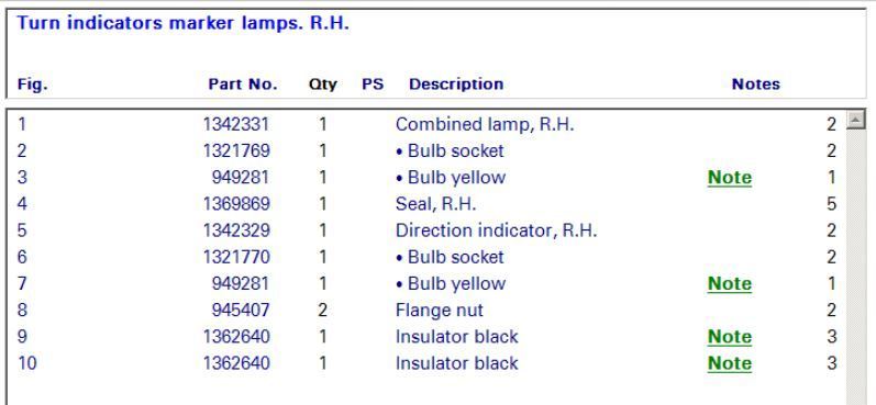

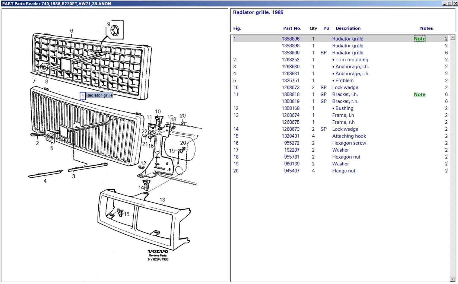

oops, thought I'd posted this already. here's the parts diagrams for the US stuff. I'm pretty sure the grills are the same, but the grill page also has the surround and mounting clips... the left and right turn signal pages had the same diagram so I just pasted the right side parts list. on the headlight assemblies page, the #4 part bolts up to the body panel behind the headlights, on either side of the radiator mounting frame.... note the quantities of the various parts...
