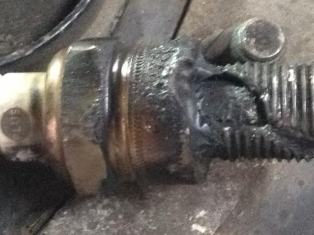

Hey all, figured out the bogging issue. Combination exhaust leak at the manifold, distributor cap was loose (still isn't as tight as I would like it).
Here's the kicker. #1 wasn't firing at all, take a look and you'll see why.
First, there is a thread insert for the plug, somebody did a job getting one in or out at some point so a insert was added. But you can see from the plug that it cracked and burned, can't be good?

wow, can't say I've ever seen a spark plug that looked that awful.
I dunno but I think at this point, I'd be looking for a replacement head

At the very least I have to get in there and see if pieces of this spark plug are in there. The good news, I think, is I needed to do the timing belt.

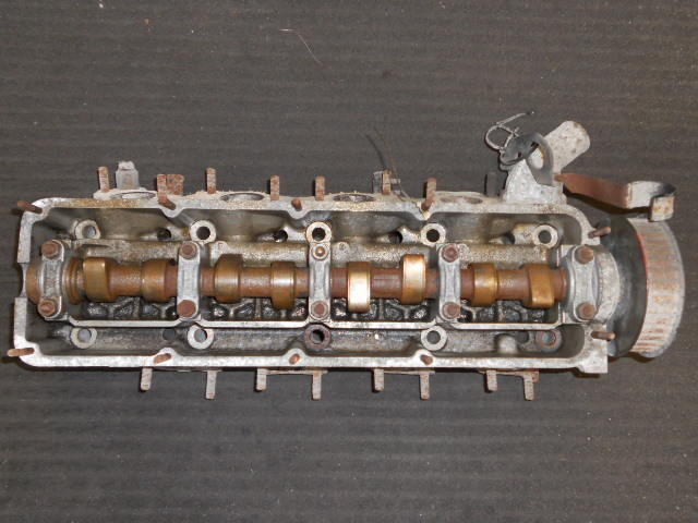

Quick search on eBay found this one.
Probably better just to replace it since that plug was annihilated, it was impressive. Thankfully got it home and in the garage. Guess the Benz is on hold now. As a bonus too there was some leaking from the head gasket. Killing a bunch of birds with an RPG on this one!

that picture looks severely corroded, like it sat outside a long time. you can (and probably should) use your camshaft, but if all the studs and stuff are corroded like that, its more work for you. and if the aluminum is pitted, ugh.
replacing the head is a top end rebuild for all practical purposes, I would without hesitation use a new timing belt, tensioner, and all engine gaskets and seals. and probably the water pump unless yours is nearly new. real volvo seals work much better than the aftermarket (chinese) stuff.

Yeah that thing looked pretty nasty, off a "85 too. Timing belt/water pump all needed to be done so it all sort of worked out pretty good. Got next week off, guess I know what I'll be doing.

I tried something similar to that and had a sleeve in there too. Something obviously didn't go right. The problem now is the tip of the plug is gone, somewhere inside I'm sure, so I have to take it all apart to find the pieces and hope it didn't do too much damage.
So it's now a project car. New head, timing belt, water pump, distributor (maybe), plugs (obviously), seals etc.... and she should be good as new.
