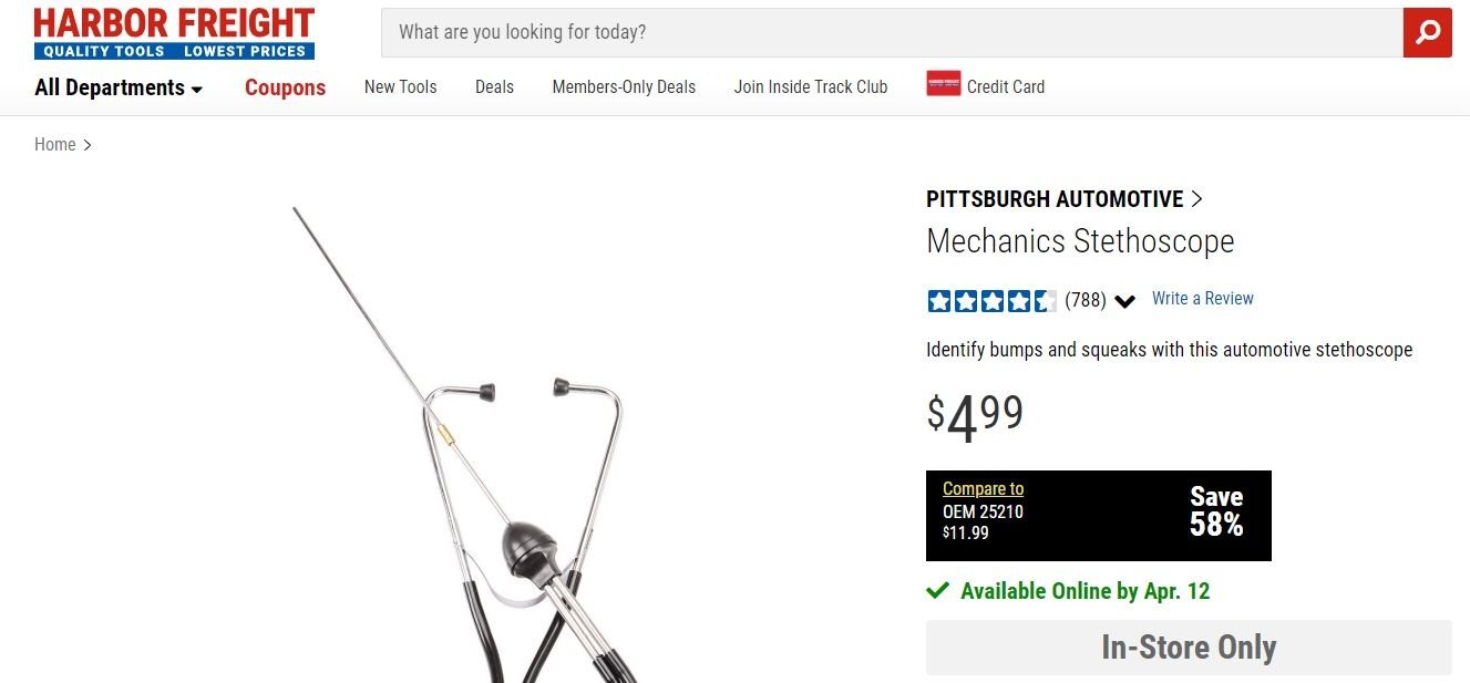

Use your $5 stethoscope to isolate the noise - or a rubber tube pointed towards various possibilities (listening on the other end) or a long screwdriver or thin metal object touching possibilities touching near your ear on the other end. Or loosen v belts, and change tension on the timing belts until something changes. I trust you used the correct timing belt for your engine - early cars have square teeth, later have round teeth.
