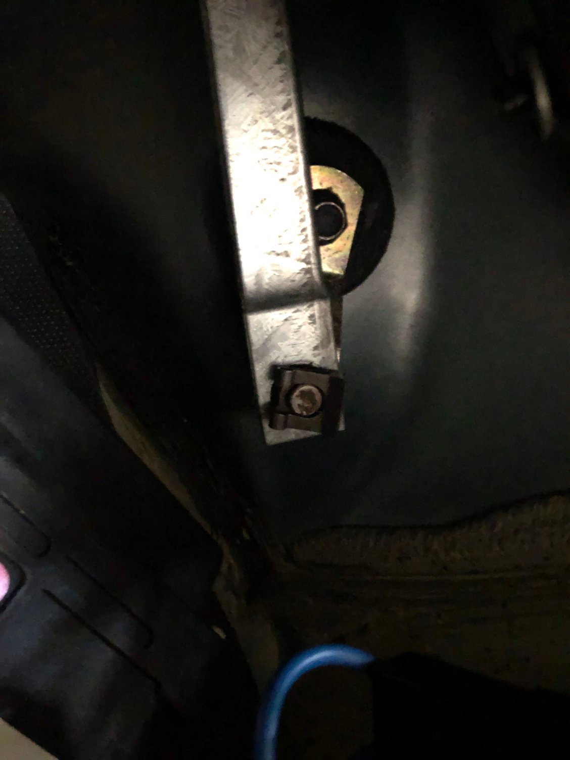

I’m doing my first car repair which is replacing the wiper motor on my Volvo 240. I’ve gotten the three bolts off of the ones that are in the hood, but under the dash , there is an arm in place over where the bolt is. In the videos I’ve watched the arm is not in the same position it is in mine it is just slightly obstructing the removal of the bolt. And of course even with the other bolts back in my wipers have decided to die once and for all. I can’t seem to access the bolt, would anyone know how to move this arm out of the way? Pictures attached.

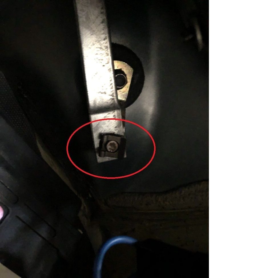

Slide the circled clip off and the silver arm comes off and moves out of the way
