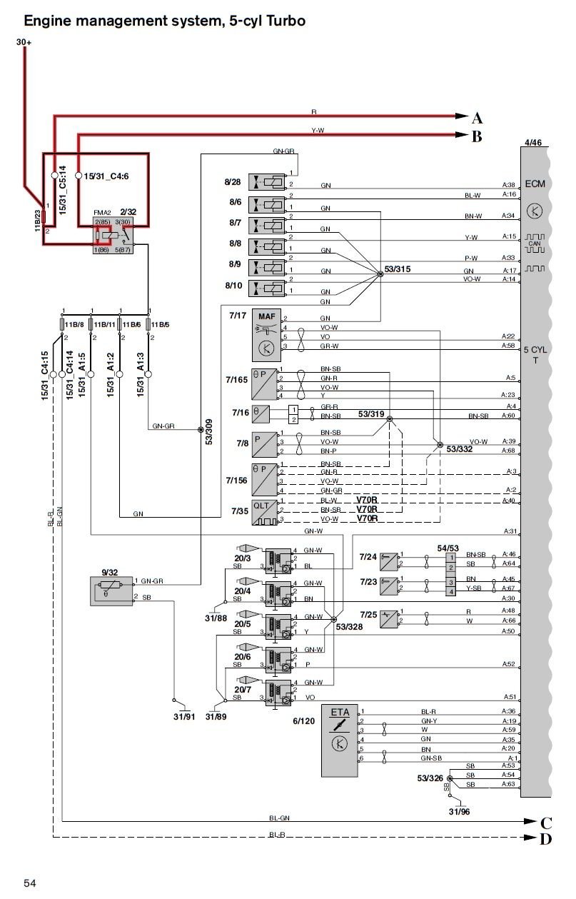

All my ignition coil wires were melted due to oil cap leaking. Anyways I'm trying to wire them back up after buying new packs. I don't know what colors go where. Can anyone please help?

Here's for a 04 5 cyl turbo. Coils are 20/3-20/7. Each has 12v on the green/white wire to terminal 4 on each coil, fused by #11 fuse in the b fusebox. With blue, brown, yellow, pink, and violet from the ECU to individual coils.
