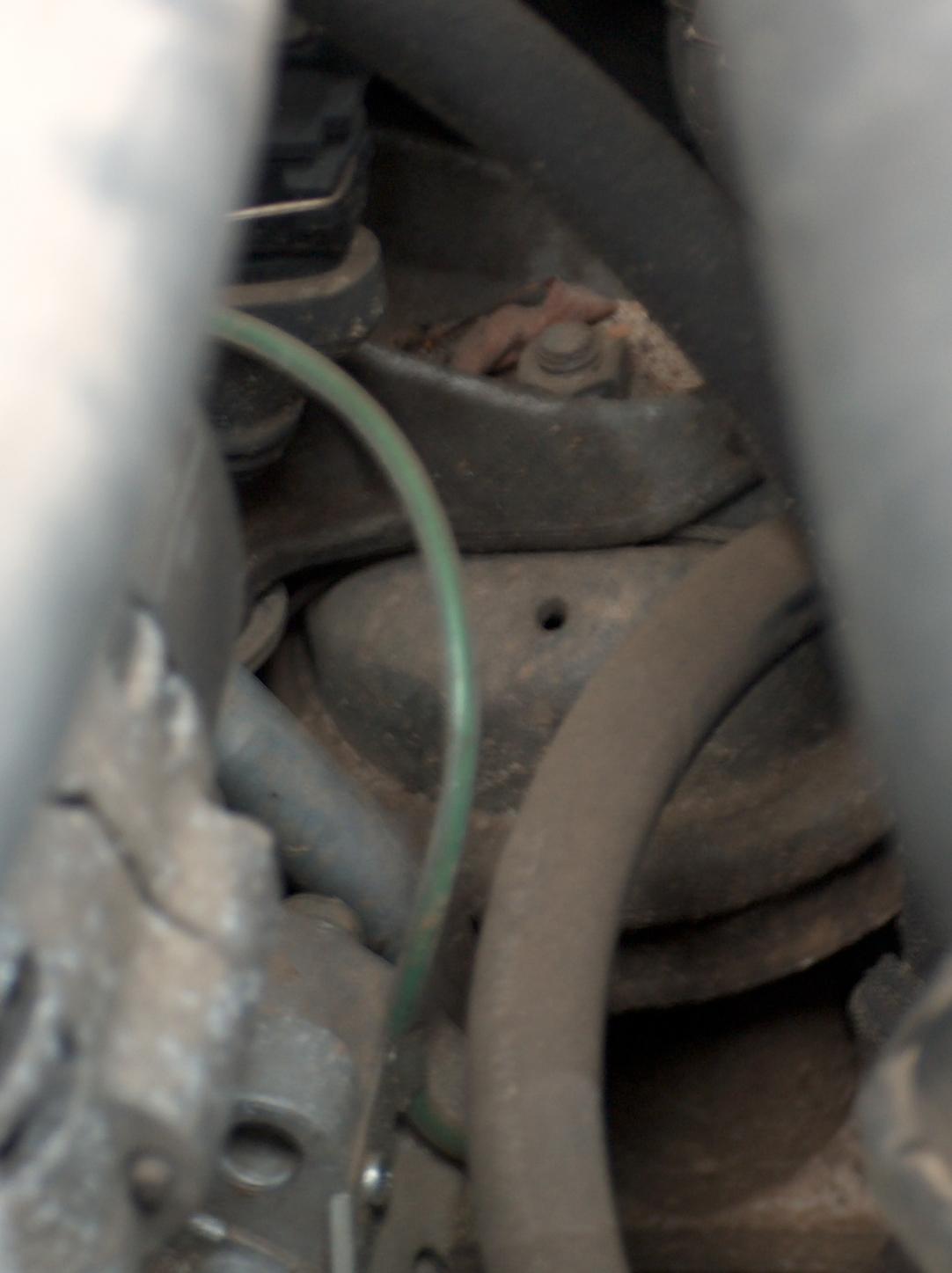

Had my oil changed the other day and it was suggested I get my engine mounts replaced. To me, they look ok. Yes, they do have a little sag but the car has over 225k. Any ideas? Thanks

Well, the best measure is if the motor is sagging to the point of resting on the cross member: that would cause extra vibration and unpleasantness... You can check that from under the car, you can see the gap. Hard to tell if the MM is collapsed just by looking at it from above.
