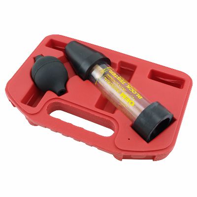

At least once a week find someplace to go to or sight see that takes you on the freeway for at least 10 minutes. That short trip driving will really gum up your vehicle. Keep an eye on the coolant but if you aren't needing to add any regularly it's just short trips and not getting the engine hot enough between cycles.
Is the PCV system open and pulling a vacuum ?? If it's starting to plug that will aggravate the situation.
If you're still worried about the gasket you can always get a block tester on loan from most auto parts stores and check to see if the head gasket is leaking but I'd bet it is just the short trip driving doing it.
