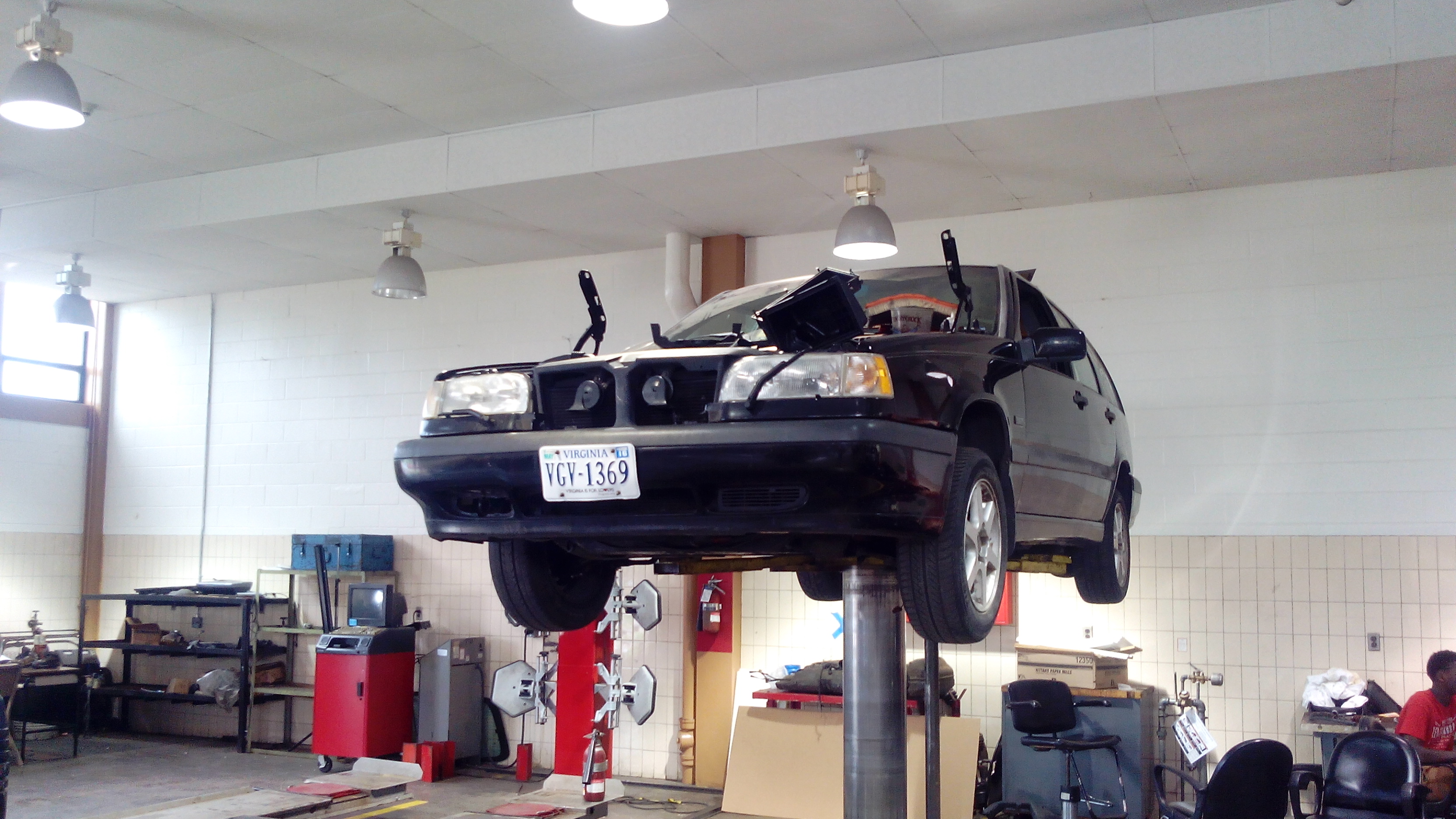

I Have A 1993 Volvo 850 Turbo I'm Working On In Automotive Tech Class, I Swaped A New Engine In And Connected Everything And Tried To Start It But it Just Turns Over It has no spark or injector pulse, I checked and the fuel pump I Checked The Crank Position Sensor with a multi meter and it works got a new camshaft position sensor still does the same thing and doesn't start I made sure and everything is working I used the A/B box and scanned for codes but A2 Fuel System and A6 Ignition System Doesn't Want To Work It Doesn't Want Blink At All It Just lightly Glow And I Know It's Supposed To Blink 111 if I doesn't work at all so I don't know what could be wrong do you guys think it could be the computer or something?
Attached Thumbnails 1993 Volvo 850 Turbo Won't Start-img_20151112_123659.jpg   1993 Volvo 850 Turbo Won't Start-img_20151112_123758.jpg   1993 Volvo 850 Turbo Won't Start-img_20151112_134405.jpg
