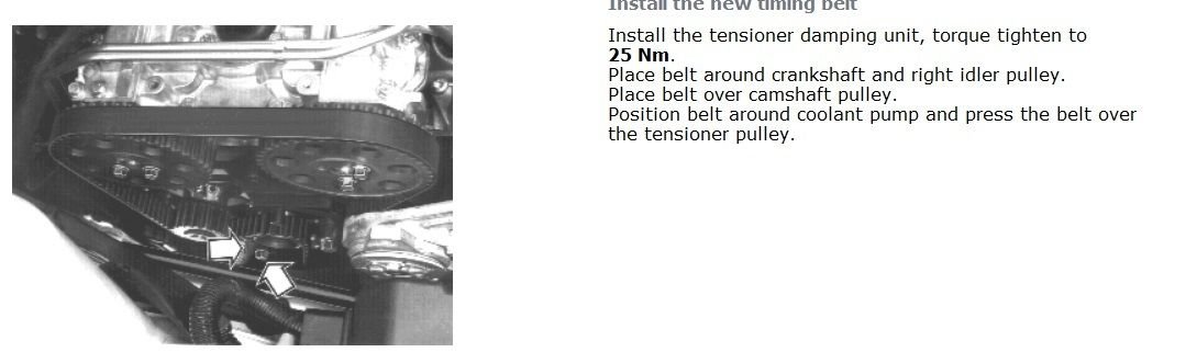

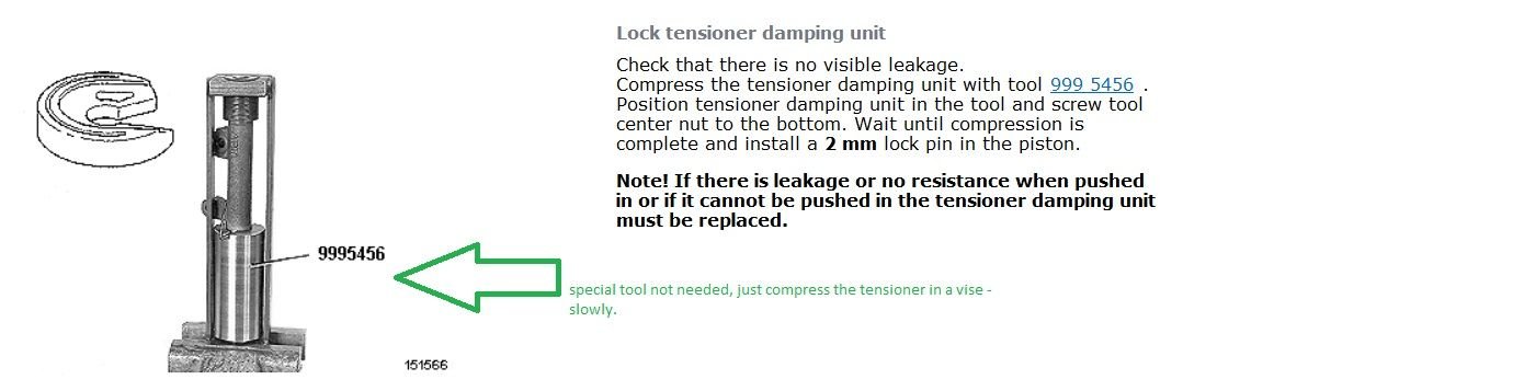

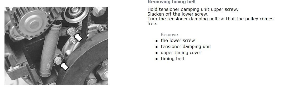

What else should I do? I don’t have a record of the last time. The timing belt was done.
That is an interference engine - meaning if the timing belt comes off or breaks you will bend all the valves - and total the car.
So I would inspect the belt before It's driven again and probably make plans to replace it and the serpentine belt. Buy a kit with idler bearing, tensioner bearing and belt and replace all three. That old car uses hydraulic tensioner - simply use a vise to push the piston back and secure it with a pin. The replacement interval on a 1994 I think was 70k miles - or 10 years and I've seen many low mileage belts fail from old age.
If you decide to replace the water pump while you are there - ONLY use the OEM factory pump. Aisen is the brand and they are available aftermarket.

Once the tensioner is out, compressed and the pin is in, is there a video or maybe a detailed post in the forums about how to make sure that the tensioner is installed properly, that the torque lb setting stuff is right? I’ve not done a lot with torque wrenches. I’ve done one timing belt myself on a Hyundai. It actually looked much harder than the Volvo but there are some things I don’t understand about that tensioner.

Old Mar 20, 2023 | 04:08 PM
Then Pull the pin to release the tensioner -
