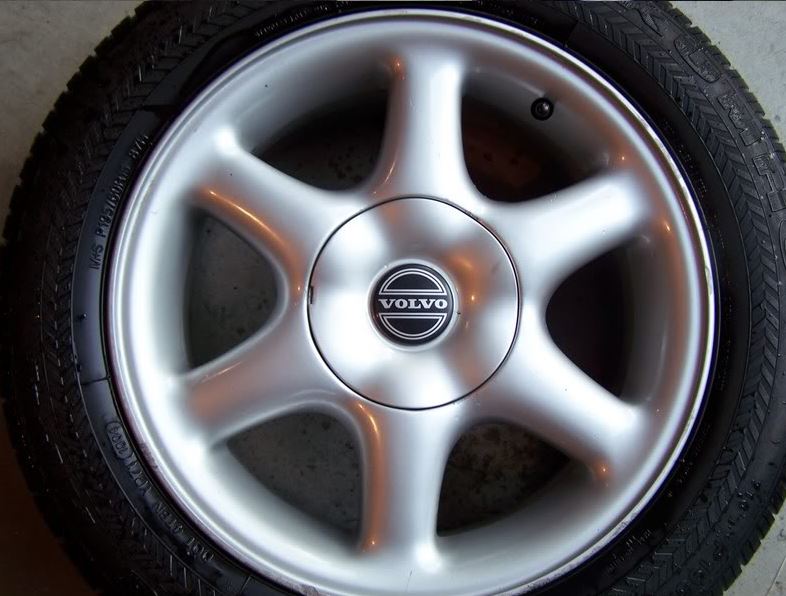

I have an extra "Cetus" rim for the 850 (no tire or valve stem as I did a repaint job on it) I'm selling. Where you located? Here's a pic of what the Cetus looks like (not my rim...)
