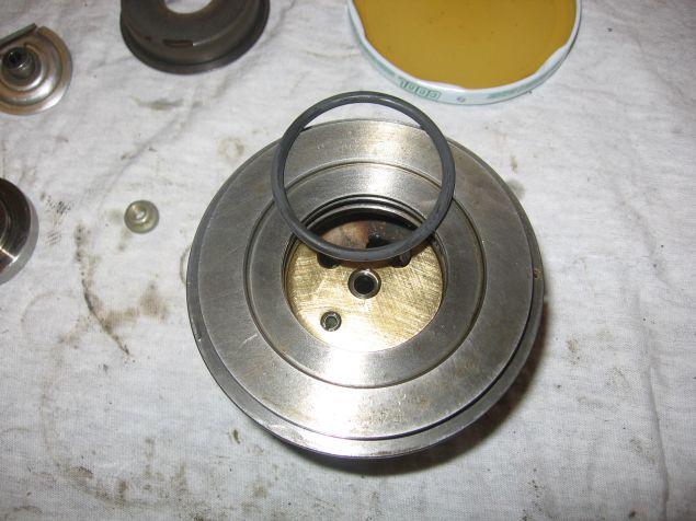

You should check to see if the turbo is turning. If you're not sure how or don't have a friend who knows how you might want to take it in to have it checked out for you. If your turbo is not spinning freely or sticking it could cause the problems you are experiencing by being a restriction to higher speed air flow to the engine instead of a help.
If the engine has a lot of sludge under the oil cap or was poorly taken care of for oil changes and not being allowed to idle for a bit after parking it but before turning it off the turbo may have a lot of crud built up inside it that's baked in there and causing the bearings to bind.
I had it happen on mine. You might want to consider using an engine flush, Seafoam or something to run with the oil to add more detergents.
I just rebuilt a 16T and it was much worse than the before picture below. The shaft bearings were so bad it was almost ready to have the fins start hitting the intake and exhaust housings.
Attached Thumbnails 1996 Volvo 850 Turbo Problems-turbo-crud.jpg   1996 Volvo 850 Turbo Problems-turbo-without-crud.jpg
