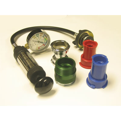

If you're lucky it's a heater hose or the line taking coolant to the turbo. Once you get the heat shield(s) off you'll have a better view.
Best to rinse off the coolant and let it dry some, fill up the overflow and start it up and let it build some pressure and see if you see it spraying.
That or pump some pressure into the system if you can get a loaner radiator pressure tester from oreilly or autozone ....
