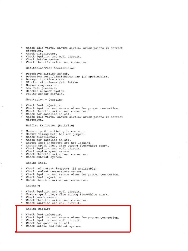

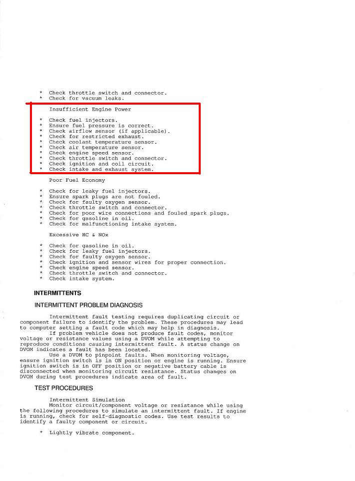

Have you noticed any fault in the transmission (arrow on the dash, low/dirty fluid or lousy performance)?
Any blockage in the exhaust system?
See attached.
