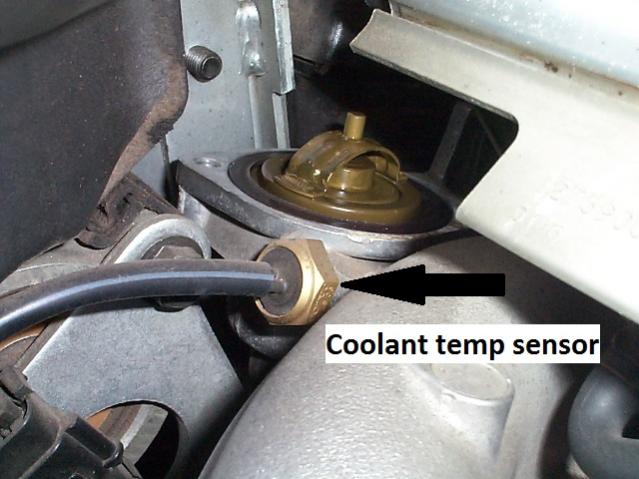

Old Mar 29, 2014 | 12:29 PM
Originally Posted by PAVolvo850
I extracted the following codes... OBDII..
PO117 - coolant temp switch.
PO440 - Evap
PO715 - Input turbine speed Sensor A circuit malfunction
My guess is the CTS...
I would replace the Coolant Temperature Sensor first thing. It might not be the whole problem but it can be.
Attached Thumbnails 95 850 Wagon almost starts-coolant-temp-sensor-installed.jpg   95 850 Wagon almost starts-coolant-temperatur-sensor-new.jpg
