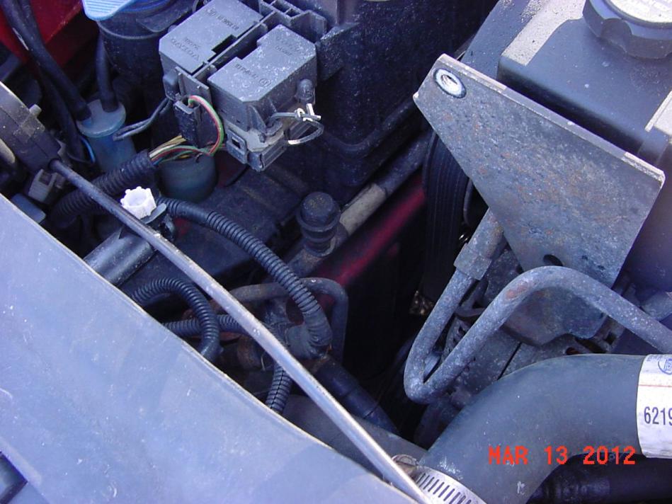

Old Jul 3, 2012 | 11:19 PM
No, most vehicles have a high and low side port for diagnostic purposes. The high side is the bigger of the two connections and the one that people come back and bitch about how the 25, 35 or 45 dollar cans of DIY freon don't fit their vehicle. It's like OBDII, they are all the same and if it doesn't fit it's because you're trying to hook up the connection to the high side
On our 850's they didn't provide a high side port I can find.

Old Jul 6, 2012 | 11:24 PM
It's late, it's dark, climbed over and under and it doesn't have a high side port I can find. Every time I think I know what engineers do they go out and have a three martini lunch and redesign something.
Revised statement: almost all cars have both a high and low side AC port. Volvo is the first I've run across that doesn't but I'm sure if they deleted it others have too.
