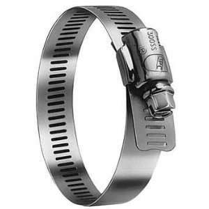

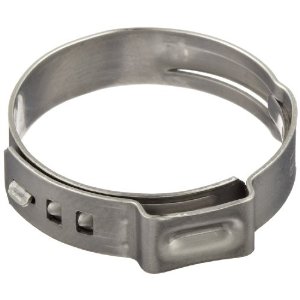

Old Mar 12, 2013 | 02:56 PM
Ok then,,, Most of the clamps on the coolant and intercooler hoses are a standard style, reuseable clamp. I think there are a couple at the IAC (idle air control motor) that are the "Oetiker" style where they are tightened once and usually need to be cut off. They can be replaced with anything you want to use. If you've done CV boots you've run into the Oetiker style clamps as they are used in that application almost exclusively.
On higher performance engines like turbos or supercharged where you go through the trouble and expense of using silicone hose or if you just want to add some "detail" I'd recommend spending the extra $$ and going with the "T" bolt style or for the smaller hoses fuel injector clamps. Both are re-useable and by their design they provide for a better 360 degree seal without doing damage to the hose.
Attached Thumbnails 96 850 turbo starter installation help-clamp-stainless-steel.jpg   96 850 turbo starter installation help-clamp-oetiker.jpg   96 850 turbo starter installation help-clamp-t-bolt.jpg   96 850 turbo starter installation help-clamps-fuel-injection.jpg
