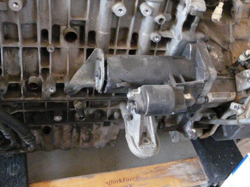

Hows this?
Attached Thumbnails Help - 1994 850 starter replacement-p1110615.jpg   Help - 1994 850 starter replacement-p1110616.jpg

Those are the two best pics of the starter I've seen yet.
Okay, from that picture its clear to me that of the two bolts I removed from the driver's side of the starter, only the first one actually connected to the starter.
In the picture you can see two 14mm bolts immediately next to each other. The other one I removed appears to just be connecting the engine to the transaxle.
On the passenger's side of the starter I'd removed the two nuts off the threads connecting the starter to the bracket. These are the two nuts in the picture, each one above the little circle (what I think is the end of the starter shaft).
So I'm thinking that maybe the '94 850 starter removal is different from other writeups I've read about for 850s and V70s which said just remove one 14mm bolt on the drivers side, and two 12mm bolts on the passengers side.
I removed two 14mm bolts (again, one which seems to just be a case to case bolt that I need to put back) on the drivers side, and two 8mm nuts off the threads holding the starter onto the bracket.
However, it still seems that I need to take off that other bolt on the passenger's side that actually holds the bracket onto the engine case, right? Or maybe just loosen it enough to swing the bracket out of the way of the two threaded ends.
And maybe even a lower bolt on the drivers side of the starter as well which looks to me like it has no other purpose but to bolt onto the starter.
Thoughts?

Okay, I removed the lower driver's side bolt (14mm) and the bole holding the bracket onto the engine case on the passenger's side. Then with a lot of yanking and tugging I was able to work the starter free.
The labor quote on replacing a starter for a professional shop is about 1.25 hrs. This took me at least 8 to get this out. Man does that transverse engine make it impossible to swing a ratchet to get any of these bolts. I'd sure like to watch a professional wrench do this.
