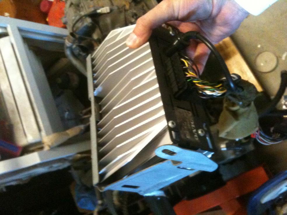

You can bypass the amp. It just unplugs. The factory harness plugs into the amp and the amp plugs into the deck. Unplug the amp from the harness and you have the factory harness.
Here is a picture of the amp...one of these days I will put it in mine I am just to lazy to do it.
