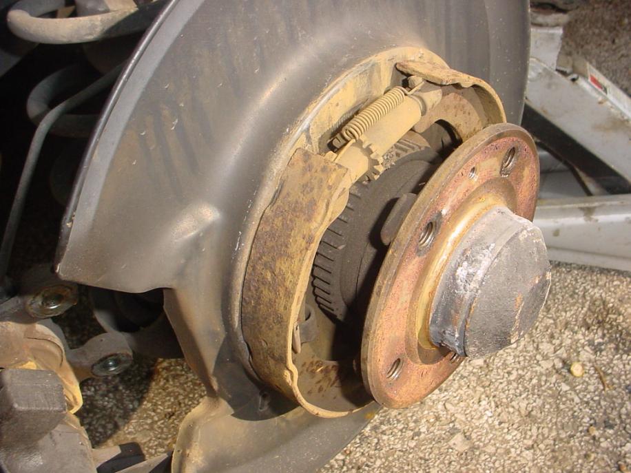

The shift lock doesn't have anything to do with the brake system so it's out.
Not pressing the brake shouldn't make a difference unless when you press the brake to shift out of park the caliper is hanging up and it's more noticeable in one direction and releases when you change direction. That I've seen.
Like Rspi said it could also be parts of the parking brake floating around inside the disc drum and jamming.
Pretty much need to pull both wheels and see and feel how the calipers are applying and releasing. If one's starting to have a problem the other likely isn't far behind. Might be time to pull the caliper mounting pins, clean, lube and reassemble.
Attached Thumbnails 97 850 right rear wheel lockup?-brakes-photo-rear-parking-brake-shoes.jpg

I'll second (or third) the parking brake. Mine did exactly what you described last year. The adhesive on the brake shoe had failed and the brake material had fallen off en masse and locked my wheel up. Bought new shoes and did both sides and good as new.
Old Nov 15, 2013 | 03:38 AM
That picture is mine and the material was missing when I pulled the rotor/drum off. From the looks of the shoe it had been a long time gone.
