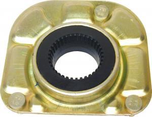

second, my passenger side front tire and suspension. on cold days (such as today), it will squeak and sound gaud awful. even after it warms up, it sounds like something is extremely worn down there. ive taken it to my usual mechanic and even the volvo dealership. neither could find anything that looked seriously worn and would cause those noises.
to date i have replaced all 4 springs, both axles, both front struts. what else down there can be replaced that would cause loud noises?

When you did the struts in front did you replace the upper mount and the coil spring seat ??
Attached Thumbnails about to start yearly maintenance, need input-suspension-upper-strut-mount.jpg   about to start yearly maintenance, need input-suspension-strut-coil-spring-seat.jpg

no, those were not replaced. new parts to order! what other parts like this should be replaced? what about in the rear? i remember seeing a foam rubber thing on the rear springs...
cheers!
