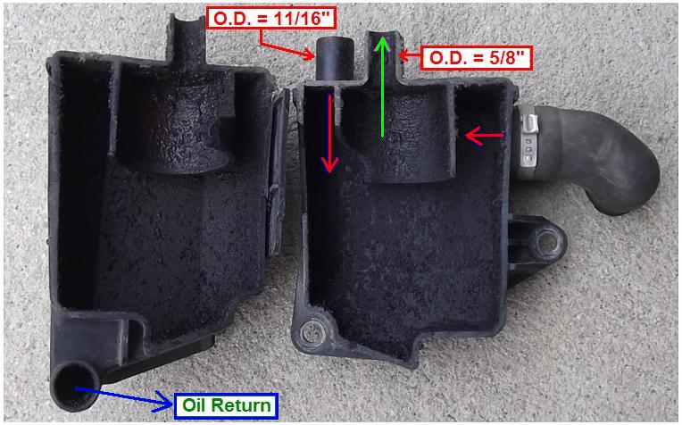

Doesn't look like anyone is interested in experimenting. That and usually it's the hoses that go bad. You can rinse out the black box. If the ports don't look blocked in the black box you don't need to replace it.
Attached Thumbnails Better / Simpler PCV System from ......HONDA??-pcv-cutaway.jpg
