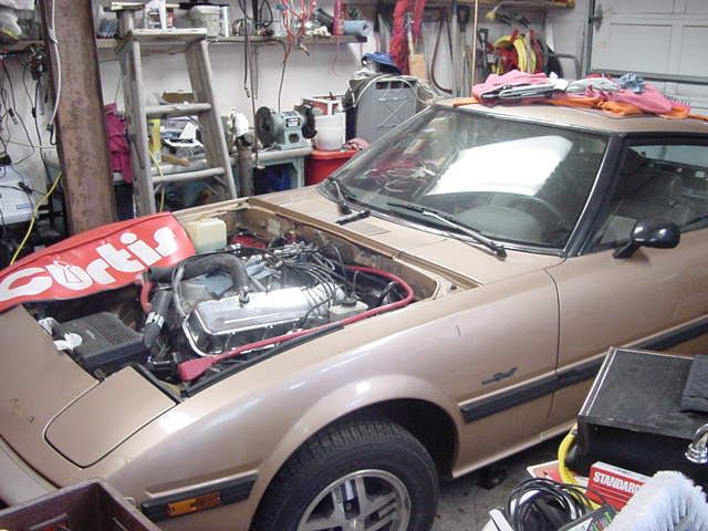

You guys are way too harsh !!
It's just a matter of money and time. I've got a '83 Madza RX-7 with a chevy 454 in it. No one believes it till they see it.
If you have a couple of months, do a lot of the work yourself and spend a few thousand dollars on the parts you need and the custom work you'll need to hire to convert and fit the S70 engine in there you'll have a nice turbo 850.
But it's likely cheaper and easier to sell yours and just buy a turbo 850. Or pass on the 70s engine and find a wrecked turbo 850 to swap in. But that's just me.
