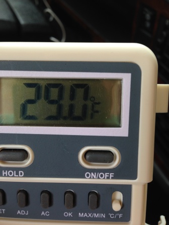

Well it's done, and so far so good. It is 24 celcius (75 farenheit) today and the a/c is working beautifully. I'll see how it goes on the long haul.
Took me about 45 minutes working under the car, and cost me about 20c.
Oh and while taking the car off the ramps the drivers one skidded, took paint off my bumper and smashed my foglight
So the job actually cost about $100 after I go and buy another fog light.
