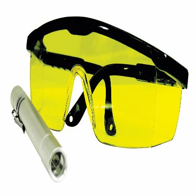

Please don't add too much oil. Since you are not seeing any oil leaking out adding it will cause an overcharge of oil and cut down on the amount of freon the system can hold. The less freon, the poorer the systems performance will be.
You should use freon with a UV dye. Let the system run for a time and then check over the fittings and hoses with a black light to see if you can find an area that "glows". You will need a light source and the glasses help to increase the contrast. The pair sell for around fifteen bucks at most auto parts stores.
Show and tell:
Attached Thumbnails A/C system leak-15-buck-uv-light-glasses.jpg
