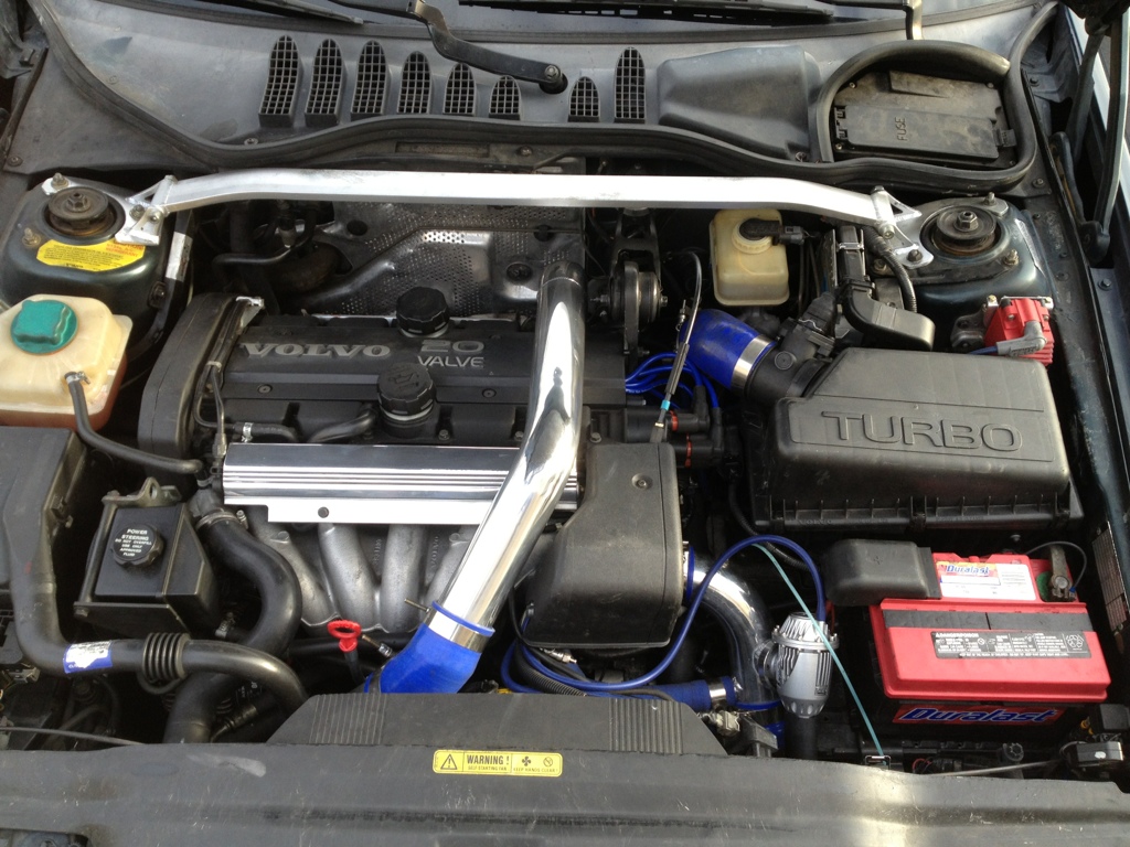

For the EGR I had an R-exhaust manifold modified to accept an EGR port.

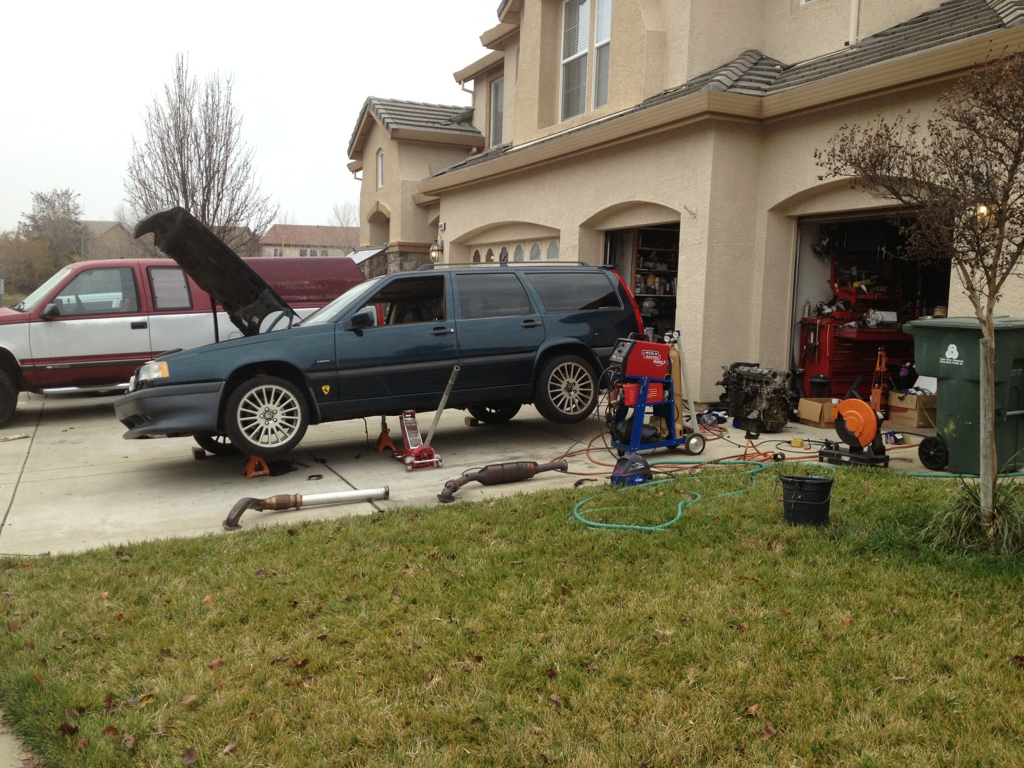

Took the flange from an angled housing and welded it to the OEM downpipe.

Swap it all out when its smog time.

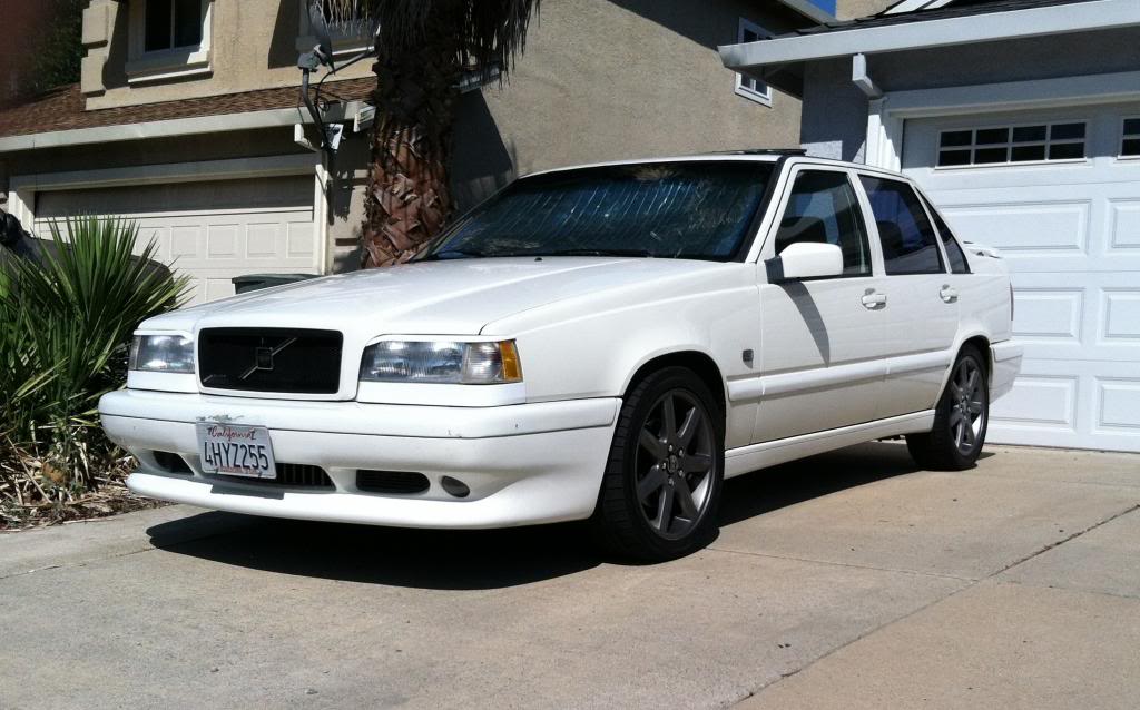

This is my car

I took this picture back in January of this year the day I passed smog.
For you, being a 97. You will not be able to make any changes to the intake. i.e. cold intake, cool filter, etc. The problem with the exhaust is that they require you to NOT MODIFY anything between the exhaust manifold down to past the rear O2. After that you can have an open pipe and pass.
You can get away with a 15G, 16T, 18T or 19T turbo because they all use the same housing, they cant tell its bigger. If you go after upgrading the exhaust you should use v-band clamps so it can be changed out. You will have to put it back to stock to smog it.
I cant pass smog at this point with the 20G on there. When its time again I will swap it out.
