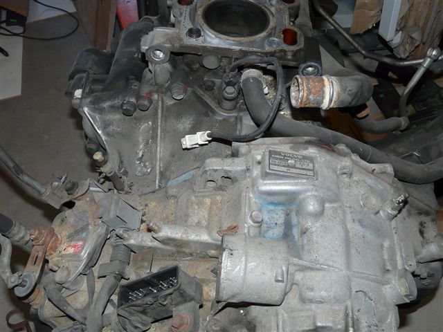

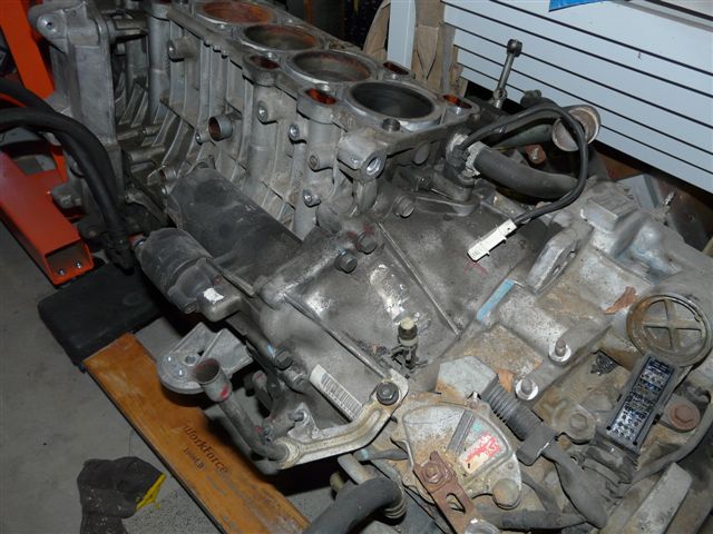

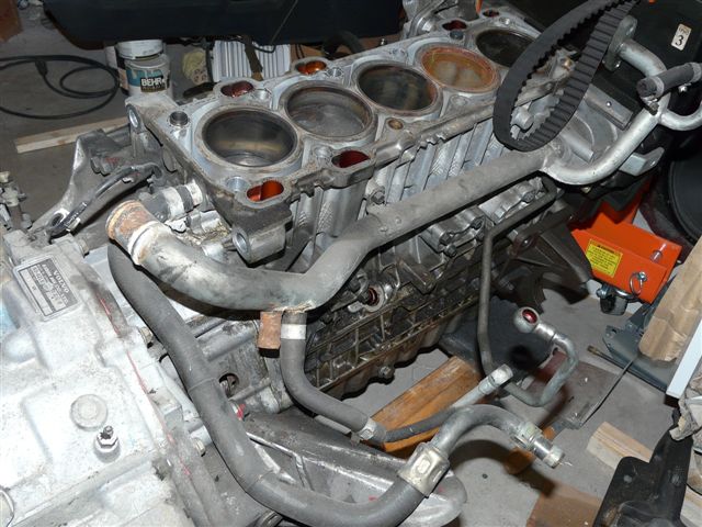

Old Apr 25, 2010 | 08:22 PM
boxpin's Avatar
Joined: May 2009
Posts: 2,702
From: Rocklin, Ca
Maybe this will help
Attached Thumbnails Coolant Leak-p1120566.jpg   Coolant Leak-p1120563.jpg   Coolant Leak-p1120565.jpg
Old Apr 25, 2010 | 08:42 PM
TurboLover's Avatar
Joined: Apr 2010
Posts: 14
Thanks guys! Tech nailed it. It was the heater core hose where it goes into the head just under the larger hose that goes around to the firewall side. This car is really not worth much time or money so I just used some 1/2" heater hose and connected it to the other hose I put in earlier that goes into the hard tube facing the firewall. Hope that makes sense. Anyways, Im stoked! The system is holding pressure and no leaks! Thank you Volvo forums.com!!!!
