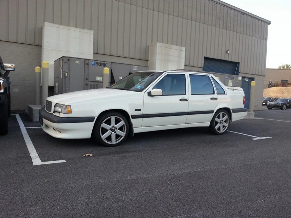

NICE!! Just read everything and just sounds like my past two months in a day.. I was going to chime in and tell you about the heater core issues I had and Pioneer stereo I added with a change out of 6 of the 8 speakers in my white sedan.. but obviously you don't need any help.. I will definitely be ordering the Showroom black and still have not had the time to get a buff, compound, clay bar, wax, and sealant for the winter.
I have had aftermarket rims similar to the 5 spoke R rims but in a six spoke design and seem to like them more than the Volans (don't kill me)
Seams like the rubber on the metal door trim on the A pillar you had removed or is straight metal.. mine is starting to peal.. should I just remove it all the way? How is your interiors Suede holding up?
