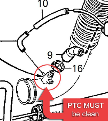

There is a difference between water (coolant) mixing with the oil and just having the creamy stuff on or in the dipstick tube or under the fill cover.
What I'm seeing in your photos looks more like condensation. When you redid the turbo did you remove the PTC and thoroughly clean it out ?? If removed did you make sure to get it back in and seated securely ? If in doubt you might want to use a little RTV (silicone sealant) to help seal it in place. Also check to make sure you didn't disconnect a vacuum hose in that area like under the cover where you can't see it. Might want to check the hoses of the PCV system and replace any that feel brittle or too soft. You might have a hose that's slightly restricted on the inside and isn't allowing enough circulation in the crankcase.

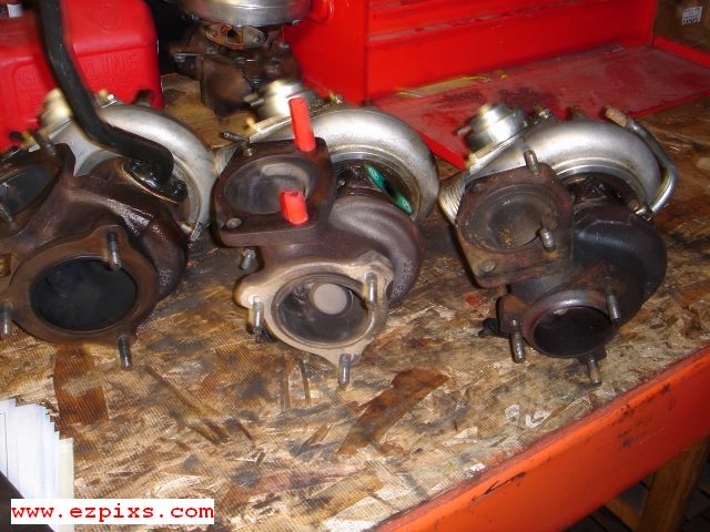

The "core" or cartridge should still be good as long as the wheels didn't get loose enough to hit the housings.
I think you have a "straight" exhaust housing. My stock one was a conical and then there is straight (flat) and angled (flat).

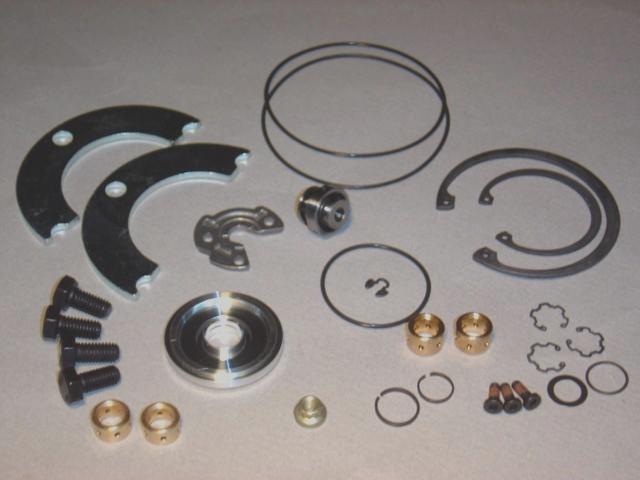

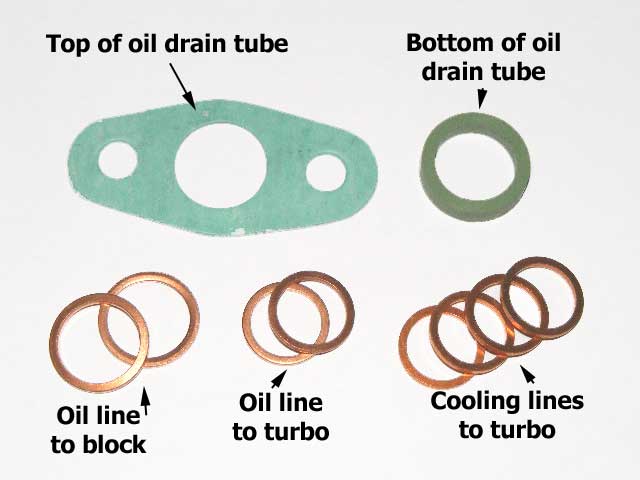

You likely need or will benefit from a turbo rebuild anyway so it's a good idea to try this first before thinking you have oil blowing past the rings. The rebuild isn't hard it's just a matter of paying attention to how it comes apart and doing a through cleaning before reassembly. There tons of videos on youtube showing how it's done along with articles on this forum and VolvoSpeed.
Attached Thumbnails oil emulsification-turbo-outlet-flanges-angled-straight-conical.jpg   oil emulsification-turbo-rebuild-kit.jpg   oil emulsification-turbo-r-r-gaskets-needed.jpg
I actually have rebuilt this turbo one and a half times already, i feel shame.
I just lucked out and got it balanced right the first time aligning the previous notches in the nut amd wheel. Second time, i wasn't so fortunate. I got it off today and saw that yhe turbine wheel did hit the housing, so im thinking i need to find a new core properly balanced. I checked out ard and it's 825 for a 16t.
