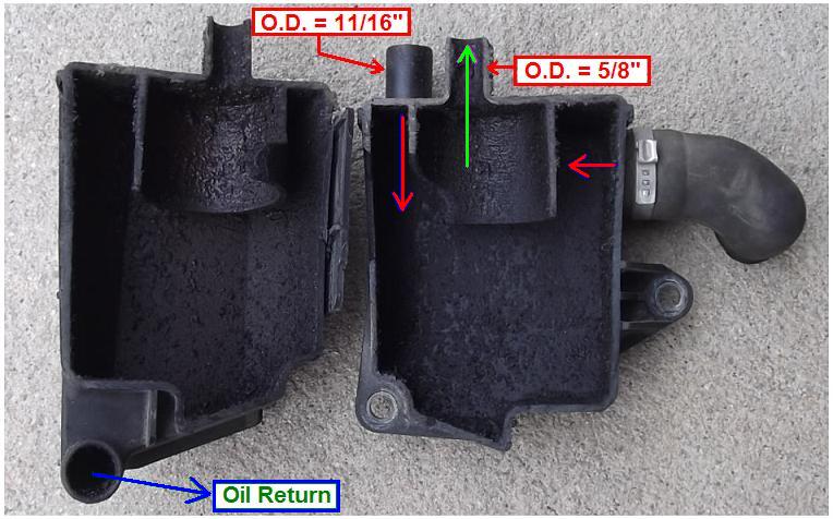

Yes that is a good price but if you want to save even more the actual breather box does not need to be replaced, its hollow. It can be flushed out and reused. You really only need the 4 vent hoses.

The mysterious "Black Box" innards !!!

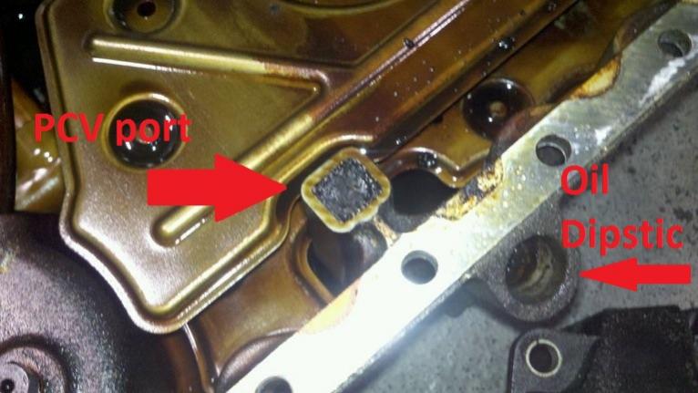

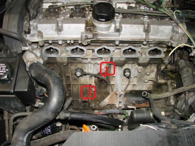

What you want to check is if the bottom port of the black box is plugged and if it isn't you still want to check if it's plugged in the pan. If you use a chunk of heater hose and try to blow into the lower port it will indicate if you have a problem in there.
Attached Thumbnails Curious-pcv-cutaway.jpg   Curious-pcv-box-plugged-port.jpg   Curious-pcv-oil-pan-passage-blocked1.jpg   Curious-pcv-drain-holes.jpg

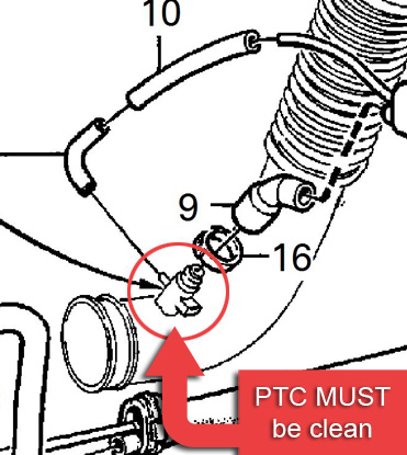

AND, make sure you clean out the PTC valve in the intake.
Attached Thumbnails Curious-pcv-parts-diagram.jpg   Curious-ptc-valve-location-intake-tube.jpg

I had no plans on removing the oil pan, should I if the bottom hole is plugged? The bigger hose of the two that's together was broken at the bend, explains all the gunk built up around the turbo and ptc.
