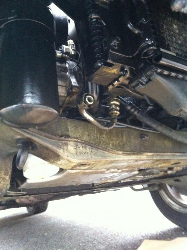

Here is the line that came undone. Filled it with oil, plugged it back in and the starter just clicks. Guessing that means the engine is seized up? After trying it 3-4 times the starter is no longer clicking either.

Originally Posted by summit
It looks like the oil cooler line come undone. Now the question is, did it shut off cause it seized or do they have a safety shut off?
There is no "safety shut off". The warning light for low oil pressure is supposed to inform you that you have no (or critically low) oil pressure and you should pull over and shut off the engine immediately or you will be in the position you are presently in.
When you added the three quarts, was it because it was off the dipstick and you needed to so it would be in the add to full range ?? Had you needed to add three at any time before ??
Sadly it's almost a certainty that your engine is damaged almost past repair. You could pay to have it rebuilt but you are more likely at the point where you'll have to make a choice between a good used engine or another car.
