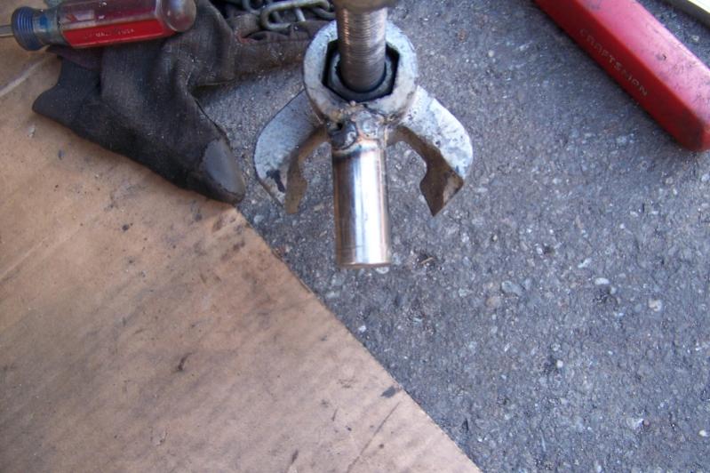

Apparently the laboratory conditions could not be duplicated in the field. I needed to modify the tool, but that didn't completely remove the bushing because it separated from the plastic/rubber. I'll use my oscillating saw to finish it off.
The first photo is of the original configuration. I think it failed to work because the bushing is exceptionally stuck in the suspension arm.
I modified the tool by welding an extra socket that fits nicely in the bushing sleeve.

Okay, so I finally got the stupid thing out... I ended up hammering a screwdriver into the plastic casing and breaking it a little at a time to free it.
Next time - use my modified tool & go right to screwdriver/hammer should make it about a 30 minute removal.
Installation was easy. I took sandpaper to the "bore" to clean off corrosion. Then I prepped it with never-seize. Finally I lined it up and walloped it with a BFH. It seated with relative ease. New bolt/nut, install bracket & bolts and I'm good to go!
