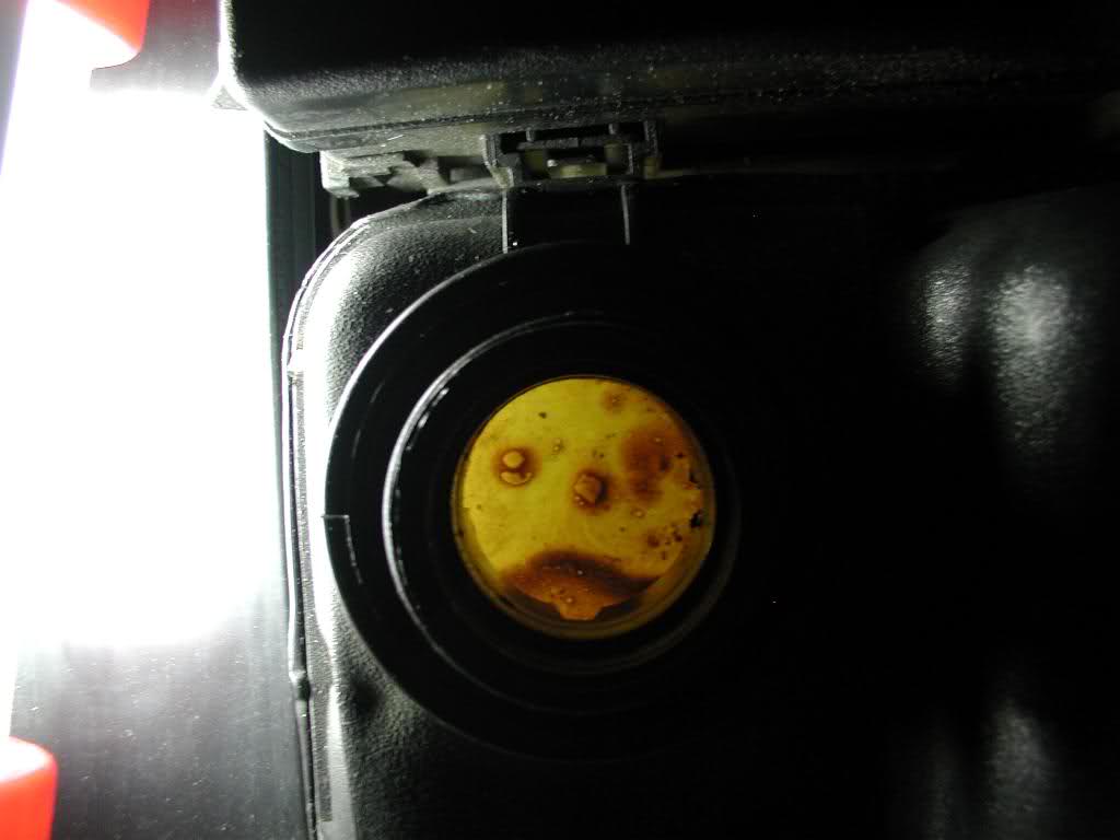

Hey guys, i have a 96 non turbo, has been in rough shape since i bought it(probably has more issues than i can diagnose). anyways, i was driving it the other day, all of a sudden started making a clanking sound from the drivers side of the engine. tried to drive it the last mile home but didn't have the power to do so, finally died on the side of the road. had it towed home and had to jump the battery to start it again, but all i can see is the engine is shaking(mainly coming from the drivers side), and a loud rattling, clanking noise, kinda sounds like metal on metal which worries me. checked my dipstick and there's a mud-like substance that smells like rust. anyone have any ideas as to what this could be, or previous experience with this? Thanks
pictures would really help for the oil and a video for us to hear the noise.
What color is your engine oil?
Was the mud like substance higher up on the dipstick or is it now the oil??
Are you having and bubbling in the reservoir tank or is there any foreign substance floating around in there at the fluid level line ??

That dipstick pretty much says HEADGASKET !!
If your oil is a light milk chocolate in color it's because the coolant is mixed in with the oil.
That may not be your only problem as it wouldn't or at least shouldn't make a metallic noise unless the headgasket leaking into and diluting the oil caused a bearing to fail. The connecting rod bearings would be the likely ones as they would be the noisier ones compared to a bad main bearing.
I wouldn't run it at all. Have someone who knows engines take a short listen to it but it's likely you'll need to take the engine out to fix that metallic noise.

Wow, thanks for the pics, looks like you have some issues there.
Let me start out by saying, if you can change brakes, you can pull the motor with the help from people on this site and others.
My guess would be that you have a blown head gasket. If you have not had the car long, it was likely already blown and it had fresh oil and coolant to try to cover it up. Did you have it long enough to check the oil before? You did take it for a good test drive before you purchased it, right?
Anyway, I would drain the oil out of the pan and see if there is any oil in the car. If you wipe the stick and re-check, is the slug back? I wonder if there is oil in it.
By the looks of the motor it was not only neglected but also mal-maintained. What is that blue wire going from behind the air box to the motor mount bracket? It should not be over the throttle cable.
Not sure what the sound is, it may be due to the fact that there is no real oil in the motor. The sad thing is, if you need to get a motor or new head the cost will likely be in excess of $2,500 at a shop. You may want to get another car.
