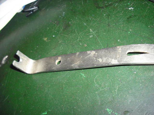

I had a really frustrating time trying to pop my gas lines off the fuel pump recently. After getting nowhere for longer than I care to admit, I altered a little Stanley pry-bar/nail puller I had, widening out the end with a Dremel tool so it would fit around those steel tubes that rise from the pump. Jam it under the rubber boot and the fittings pry off easily. Of course it's not much for pulling out nails anymore.

Thanks for this idea Tony. This was the direction I was going next if I had no success with the needle nose pliers. I think your tool is less likely to damage the lines. After scouring the forums, it seems lots of folks find removal of these lines challenging so having your idea archived for reference should prove helpful to others. Thanks for the pic as well!
