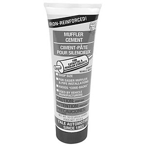

That type of joint never uses a gasket. Both parts are round and should make a nice tight fit. Possibly one end or the other has been damaged and now isn't perfectly round or smooth and can't make a proper fit.
You might try using an exhaust cement or sealant to help out. That or remove the part that looks worse and see if a muffler shop can reshape it.

well i tried the exhaust cement,cleaned everything....and STILL leaks...
