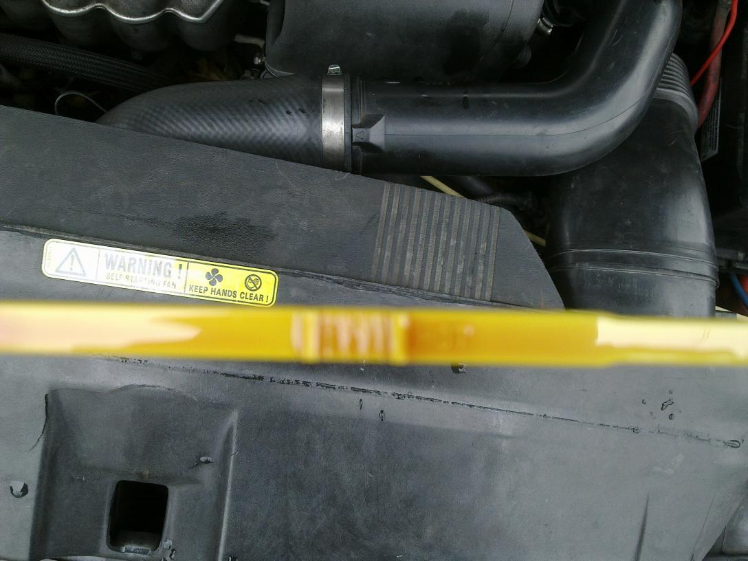

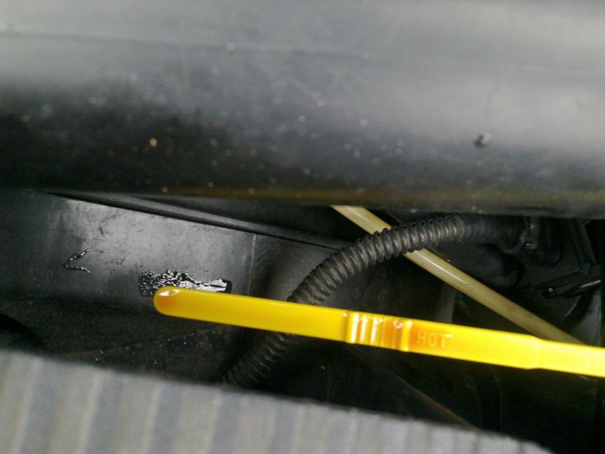

guys l just want to know if the transmission is on the right level or over filled

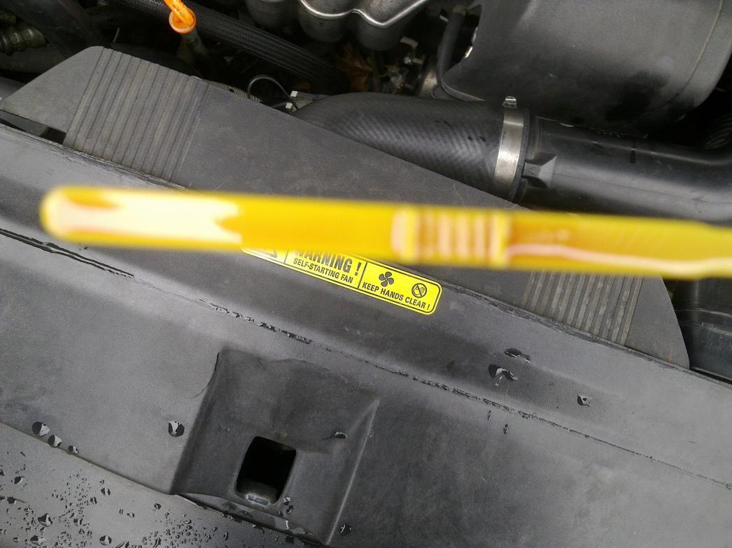

is this transmission fluid level right?or over filled

Did you check it with the engine running? It looks high if the engine was running. If it was not running it looks like what you would see.
Engine oil: Engine off
Transmission fluid: Engine on.

yea l did that with the engine running.so l have to drain some right
Old Dec 6, 2011 | 05:06 PM
Yep, to much. Drain about a 1/2 quart.
