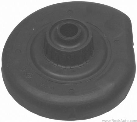

Noticing that the front end of my 850r has been getting a bit lower over time. Wheels are rubbing at full turn or at partial turn in a driveway with a slant. I have about 5 year old Koni FSDs and IPD springs. I did some inspection today and found that the upper "bump stops" are all but disintegrated... Do these guys actually do any work in the ride height... even just an 1/4" or so?
this is the part i mentioned:
Front Strut Bump Stop

They're only there for what they say. They do nothing but keep your suspension from crashing into itself. No height change at all. Sounds like spring sag or trashed coil insulator/mounts.

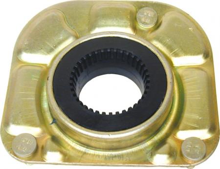

Kinda what i was afraid of... Especially at the price point of replacing one or both... What would tend to fail first.. the spring or the shock.. or do the shocks even fail? by coil / insulator mounts i assume you mean the upper spring mount? :
ipd Heavy Duty Front Upper Spring Seat

Shocks don't support the weight of the car. Gas shocks or struts because of the pressure in them expand and might cause a slight increase in ride height but it's not their function. The strut is only there to control the bounce. The spring is what holds up that corner of the car, all the weight. If it's sagging a new strut wouldn't make a noticeable difference. Either the upper mount/insulator is worn out and or the spring is starting to sag.
Attached Thumbnails Front Suspension question-suspension-front-coil-spring-seat.jpg   Front Suspension question-suspension-front-strut-mount.jpg

In other news, blerg. I pretty much replaced all components with new stuff when i did the suspension swap a while back... Easily 100k miles ago... Any guesses on what would want to go first? I know what the upper spring seat feels like when the rubber finally breaks. Pretty sure its not that.. ( you can see the play if you bounce that fender up and down with the hood open. Mine ist doing that yet, as they were new when i did springs and struts ) The other component you pictured, the metal strut mount ( the swiveling metal component) i bet i used the existing stock ones..do these go bad?

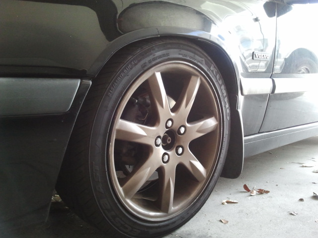

After re-reading this, im realizing that i may have mis represented the symptom.. Is the car lower? not necessarily... But what it is doing is rubbing a whole lot easier than it used to in the front, like turning while going up a driveway, or hitting a speed-bump hard. I think its just the shock not dampening as well as it should.

Edi, adding video here... At first it didnt seem too bad, but after viewing the video from this perspective, it s worse than i thought. This would be the rubber spring seats going bad, yes? Usually i would hear a clunk, but thats when one is fully seperated correct? is there a "worn out stage"
the good news is that i have a pair of HD seats sitting in my tool box. The yellow foam/rubber bump stop under the fender is pretty trashed though too. I should at least order some of these too yes... ? and perhaps the metal mounting seat? (forget what thats called again)

Driver side wheel, photo FYI

You really have blow spring seats. That's why the car is low and you see those tops poking out.
If you can't turn the tops around the mounts are probably fine but if you have to pull them to replace the spring seats go ahead and do the strut mounts as well.

Robert, yes, the tops don't spin at all, i tried, very tight feeling. HAHA, i love your description of "Square wheels"
Well, sounds like i should order the mounts then too. I will go ahead an do that. I will need to get the rivets for the rear bumper too
I really loved the 215 profile when the suspension wasn't crashing around on these LA roads! No regrets there, seems to add a bit of cushion but probably why im rubbing so bad now.. ;-/

*** Update... went to town and fully disassembled front springs/ struts / seats and mounts... All parts "looked" in great condition. The spring seats looked like new, the strut mount bearings were intact and spun freely. The only thing worn was the foam bump stops, and they were "obliterated" I cleaned everything up really well, back the sexy bronze and blue of their youth. I happened to have an extra new set of spring seats, and i got some new dust boots and bump stops at the parts store. Re assembled and boom city! Woudja believe, no more rubbing of the tires!! )
Now, its still fairly harsh, but that might just be LA roads, and 4 plus year old struts... (installed in 09, thanks IPD for looking up the records of when i actually purchased) but it seems most of my issues have evaporated. I will mention a few things, the video i posted of the spring tops moving up and down... well, with the NEW spring seats installed I am seeing about the same amount of play. For my own record, I will consider that "normal" going forward. That said, perhaps they were just a bit worn and causing a bit of sag or too much flex, because all I really did was replace them AND the bump stops and I have a noticeably larger amount of room between the fender arch apex and the tire. ( perhaps 1/8 to 1/4 inch if I was a bettin man.
Long story short.. I have to believe that the bump stop must be doing some ( even if verrrry small) amount of work in raising ride height. OR the spring seat was just a tad more flexible than new.. or both, which i suspect ...
